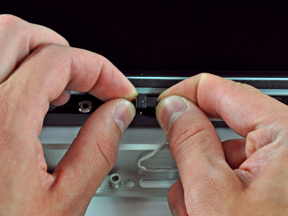

Could it be this (the connection cable for the microphone)?

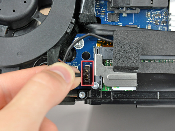

Could it be this (the LCD temp sensor)?

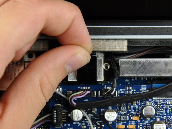

Could it be this (the data display connector cable)?

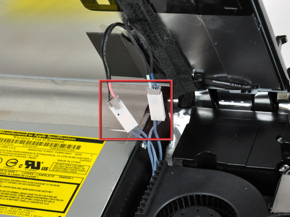

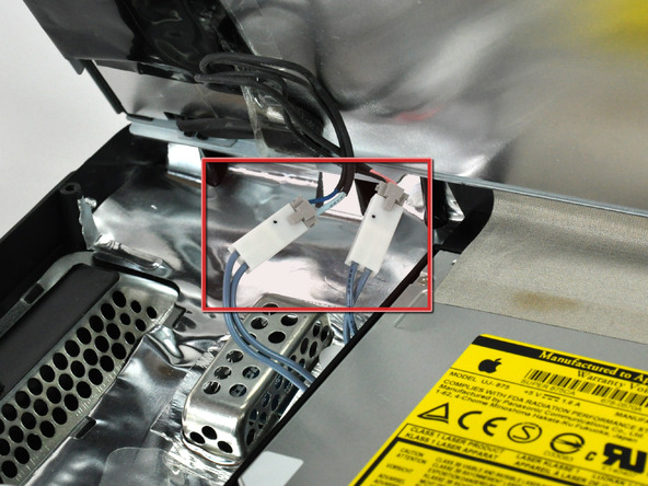

Could it be this (the inverter cables)?

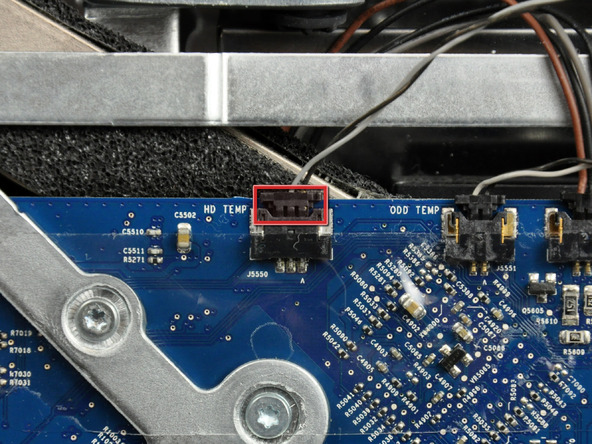

Could it be this (the HDD thermal sensor)?

If the microphone connector isn't in properly.... That could cause it to not work?
I doubt that, as I recently put an Optibay into my MBP and had to disconnect the Bluetooth / AirPort cable and was still able to boot, though I just had no AirPort and Bluetooth.
It seems there is some other cable loose. You have to reopen it in order to troubleshoot.

1. LVDS (data cable in the pictures) cable not connected correctly.
2. back light (all 4, two on each side) cables not connected correctly.
3. display, LVDS cable, logic board or inverter board is now broken.
While your friend was holding up the monitor, there may have been some strain on the connectors and you may in fact NOT be getting a connection now, even though the connectors appear to be in place. The wiring inside may have become strained and separated from the connector.
