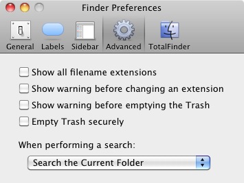

Side note: You can stop that annoying "Are you sure" message in the Finder preferences.
Well, thanks so much for the help and that little tip! At least I am spared the misery of holding down the option key 🙂
