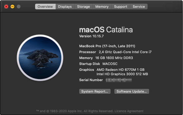

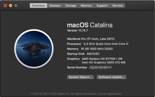

After the steps below, I'm seeing again both graphics cards in "About This Mac" of my MacBookPro 17" Late 2011, running Catalina Patcher.
1. Shut down the computer. Plug in the power adapter to a power source if it's not already connected.
2. Press Control+Option+Shift+Power keys to reset the SMC
3. Boot and press Control+S immediately after you hear the startup sound.
Then enter this command:
nvram fa4ce28d-b62f-4c99-9cc3-6815686e30f9:gpu-power-prefs=%00%00%00%00
4. Then type 'exit' to reboot.
5. Then shut down again the computer.
6. Boot and press and hold the Command+Option+P+R immediately after you hear the startup sound.
Hold these keys until the computer restarts and you hear the startup sound for a second time.
