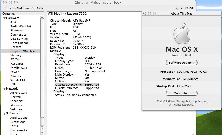

Check This Out!
I enabled Quartz 2D Extreme on my iBook 800 G3. It works great, everything
feels a little bit faster! I included a pic so you guys can see.

I guess, the fact that the iBook G3 doesn't support QE2D would explain why that poster doesn't see any negatives to running it, and so many others report that it's buggy. 😀 Hmmm...maybe I'll try turning it on, on my iBook G4, for giggles.

I think if you use the sudo defaults write method, then you can change the flag whether or not you have support. I don't know if this is somehow actually changing the way Fred's machine works, or if it's psychological. 😉
No offense to Fred, hopefully, but the fact that the iBook G3 doesn't support QE2D would explain why he doesn't see any negatives to running it, and so many others report that it's buggy. 😀 Hmmm...maybe I'll try turning it on, on my iBook G4, for giggles.
