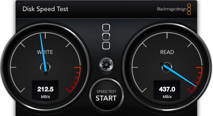

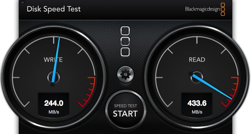

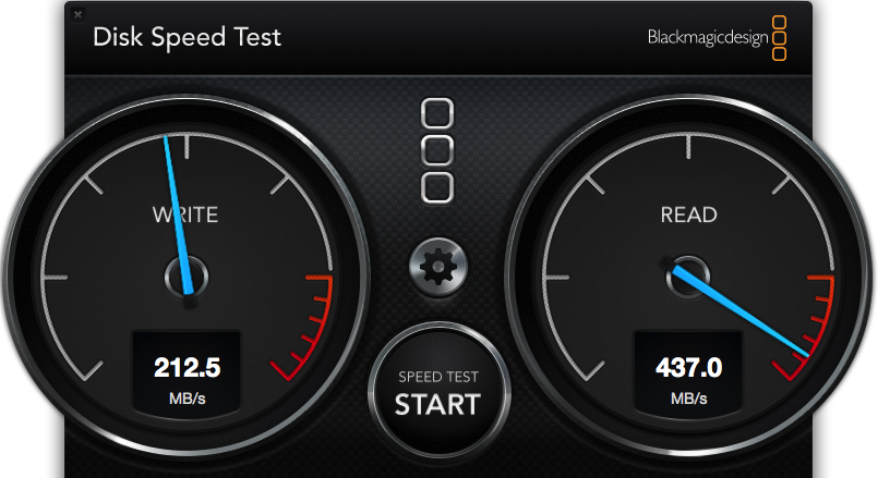

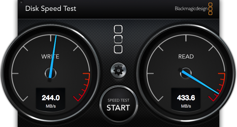

here ya go:
slower one is with trim enabled. the other is trim disabled. i used the 5gb option.
