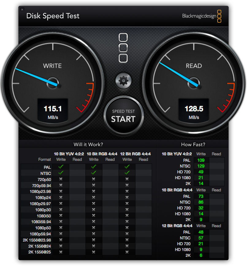

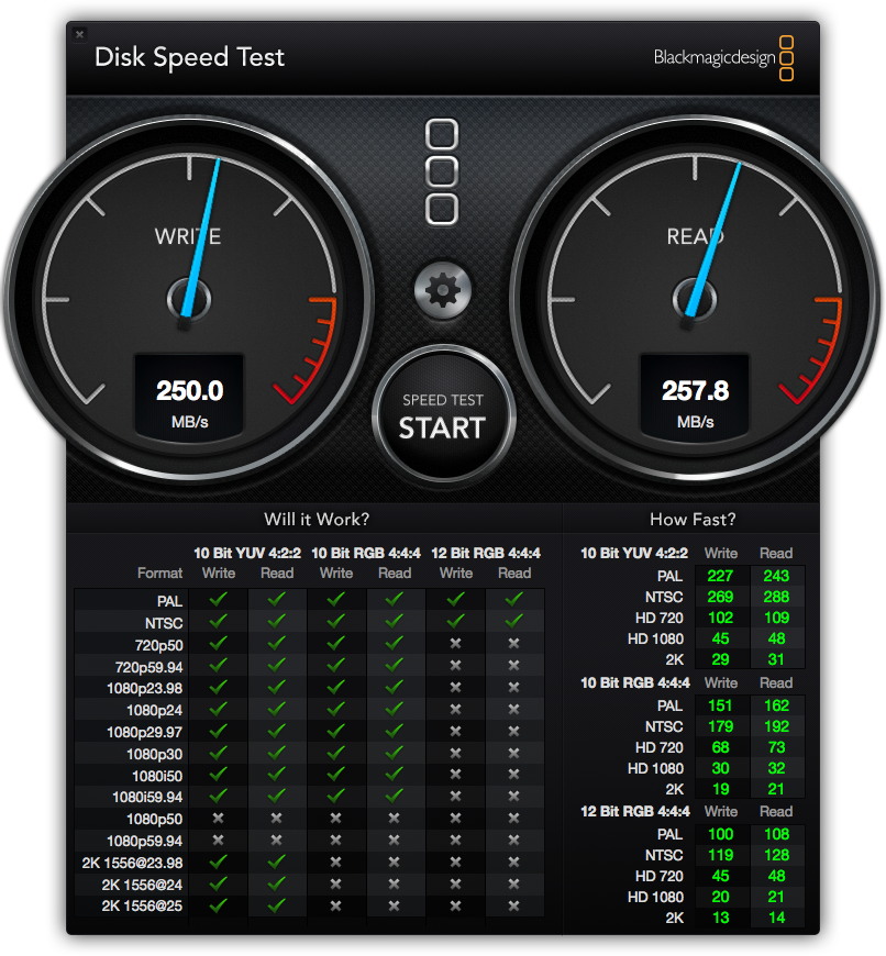

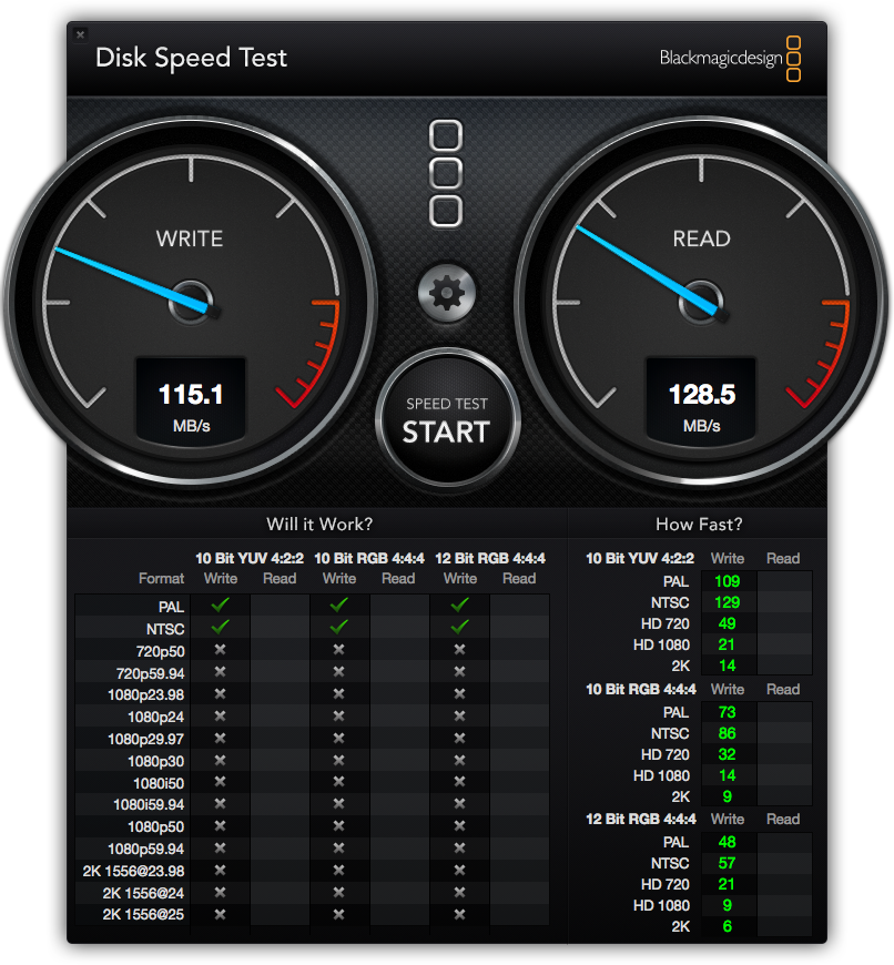

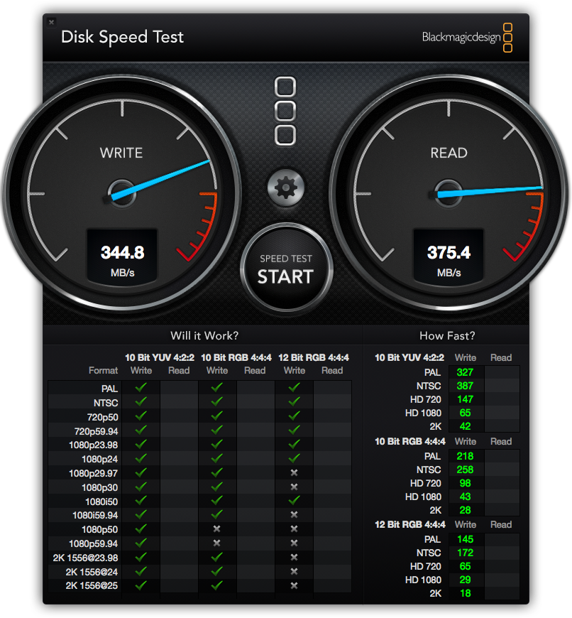

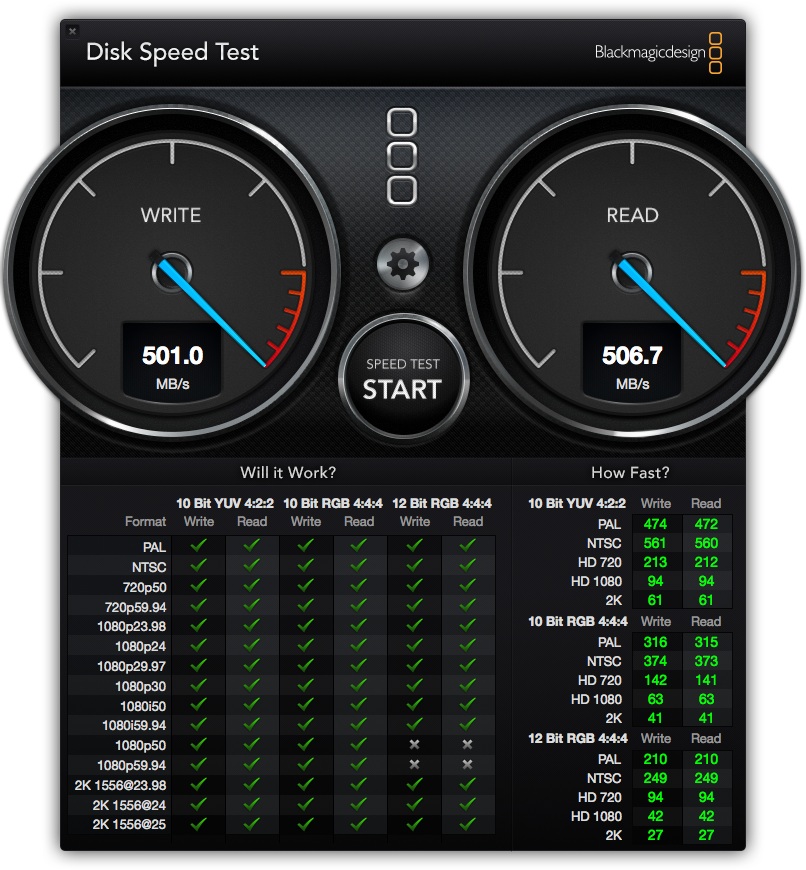

I received my Pegasus J4 and loaded it with 4 HGST Travelstar 1TB 7200rpm hard disk drives. It is a really nice looking unit.
I found it wouldn't even see the drives without first loading the driver. Once the driver was loaded and rebooted, I used Disk Utility to create different RAID-0 arrays and tested them with BlackMagicDesign "DiskSpeedTest" with 4GB test option. I ran the test on a single disk, 2-disk, 3-disk, and 4-disk RAID-0 configurations. I also ran the AJA test which produced similar results.
Results:
config ....... Write / Read MB/s
1 disk ....... 115 / 129
2 disk ....... 250 / 258
3 disk ....... 345 / 375
4 disk ....... 501 / 507
I like it! 🙂 😎 🙂
Of course, running 4 hard disks in RAID-0 ... YOU WILL WANT TO KEEP A GOOD BACKUP STRATEGY!
-howard
Results:
I like it! 🙂 😎 🙂
