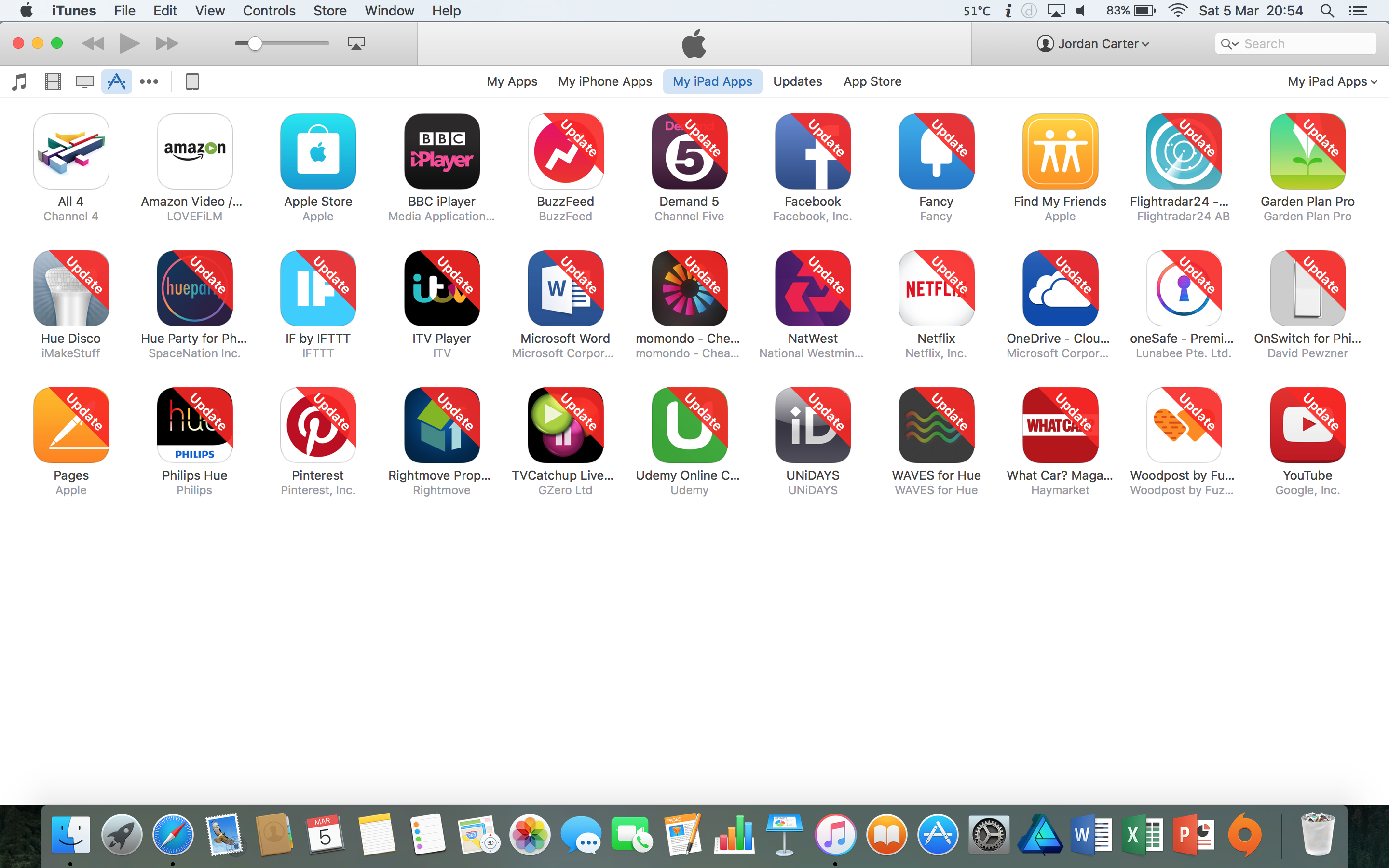

I've got automatic downloads turned on already. I plugged both my iPhone and iPad to my Mac and then tried to transfer purchases by using File > Device > Transfer Purchases. It says it's done, but hardly any of the apps are showing up? I have around 50 apps on my iPad all updated, yet this screen is only showing 33 with most of them still saying 'update'. Any idea?
Unfortunately, it does not seem to work reliably anymore since iOS 9. You may have to download the apps manually in iTunes to get the copies. You only have to do this once, as new apps will be downloaded and updated automatically.

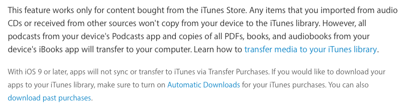

https://support.apple.com/en-us/HT201267
Since iOS9 that only transfers things like music and books you bought from Apple and no longer transfers apps. This is because of the new app thinning feature of iOS9.
