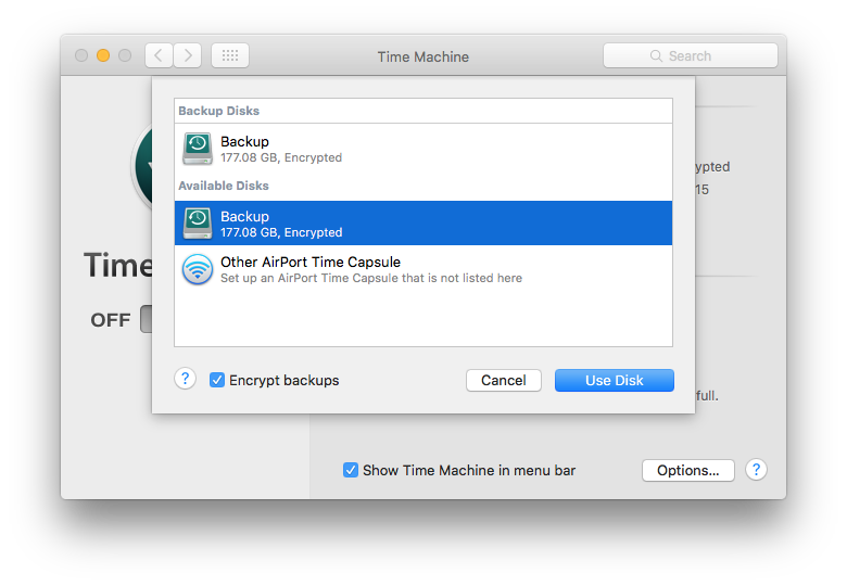

If I want to enable it on an existing Time Machine backup drive, where it the same box to check? It does not pop back up. Also, I'm assuming that even though the drive is encrypted, if I use a weak password than someone who really wants my data can use a password program with brute force to somehow guess it?
Thanks.
Thanks.
Just open Time Machine preferences then click select disk and you will see the checkbox there. Mine is checked already, but if you don't have encryption on, it will be unchecked and you can check it to encrypt.
You want a good password on there, but I don't think you need to go nuts. 🙂
