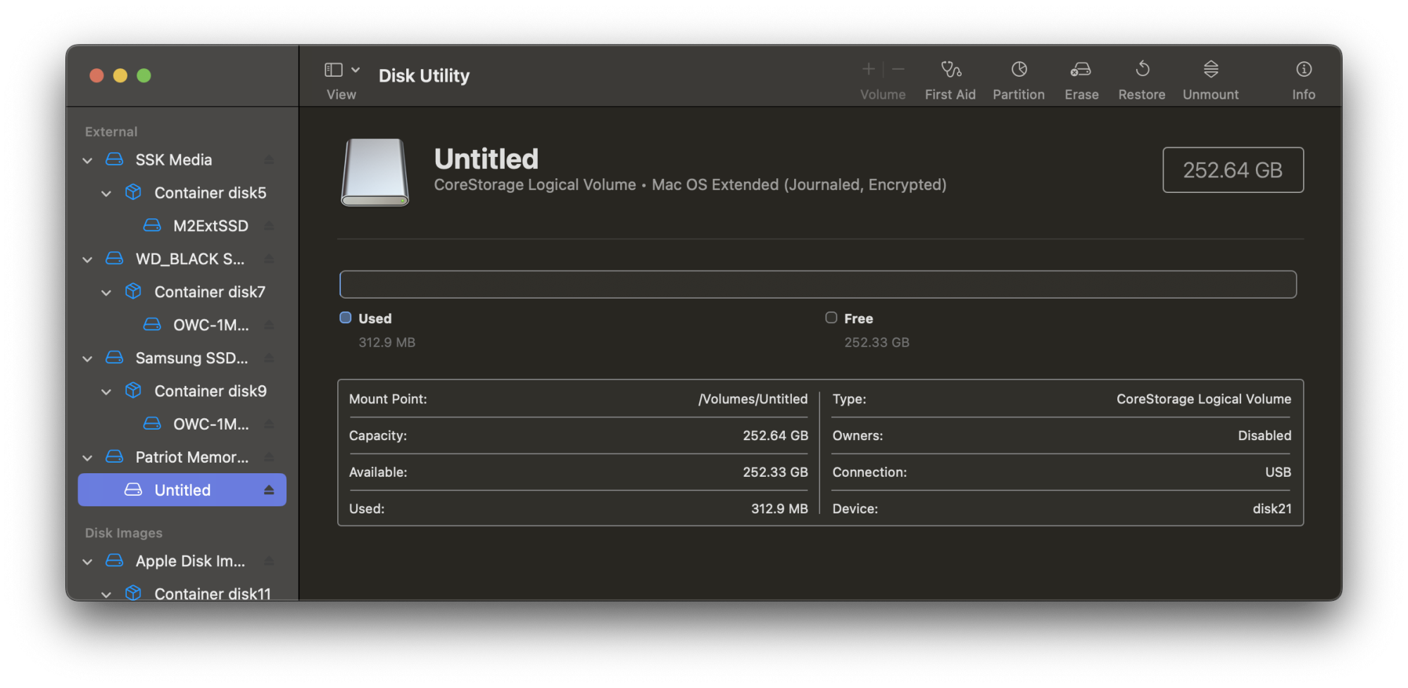

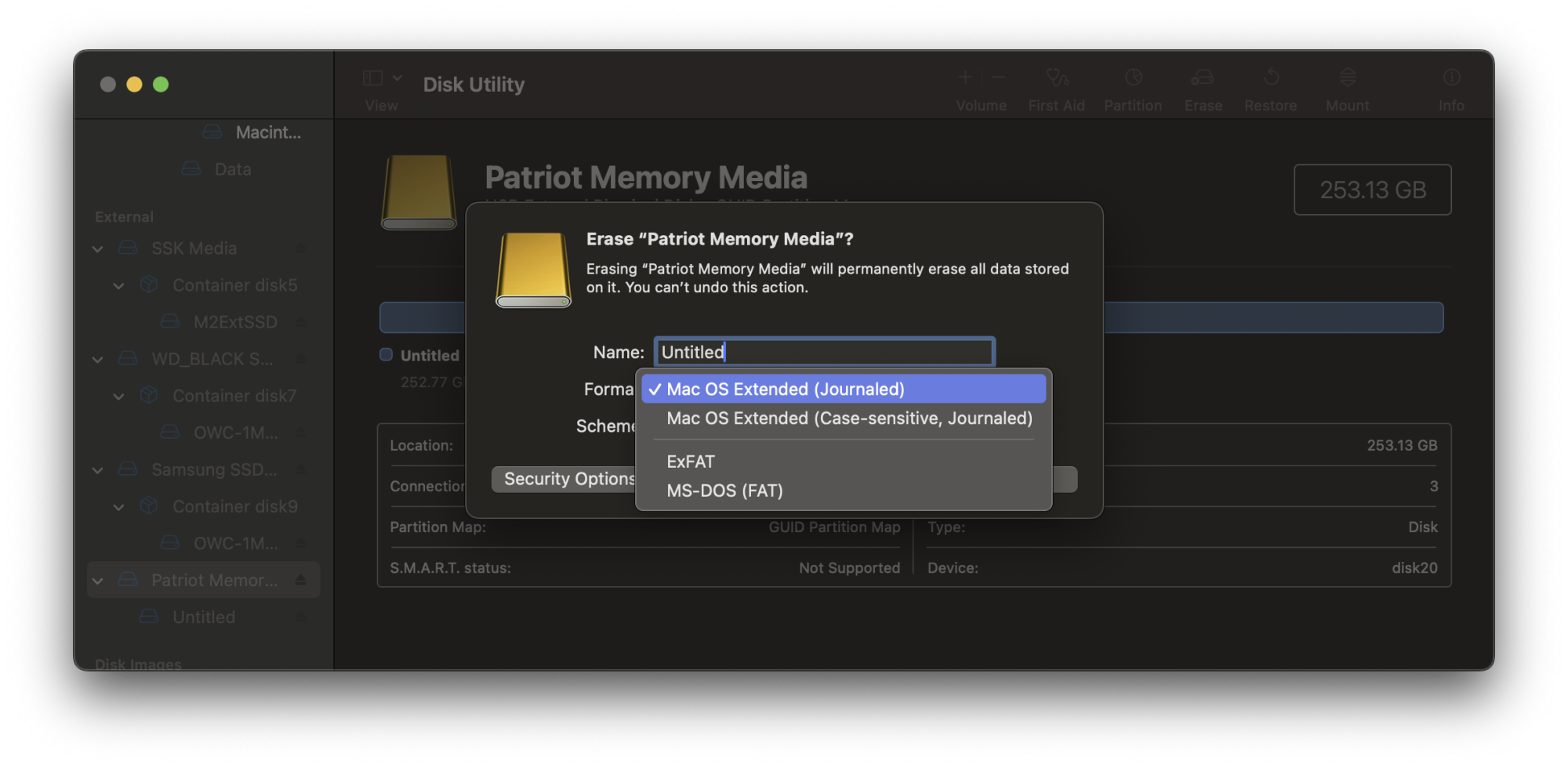

1. If I encrypt a drive with Mac OS Extended (Journaled) format on an older machine I have (2011 Mac Book Pro) would the same apply or is 256 bit a later development?
2. If I encrypt a drive on the 2011 machine in Mac OS Extended (Journaled) format would the 2019 machine be backward compatible and use it without any issues?
3. Is the opposite true, that a drive encrypted with Mac OS Extended (Journaled) format on the new machine work on the old one? I mention the format as I think APFS is a more recent development than 2011.
Thanks again.
Some (hopefully easy) questions:
Thanks again.

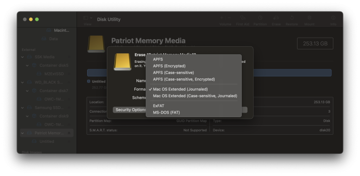

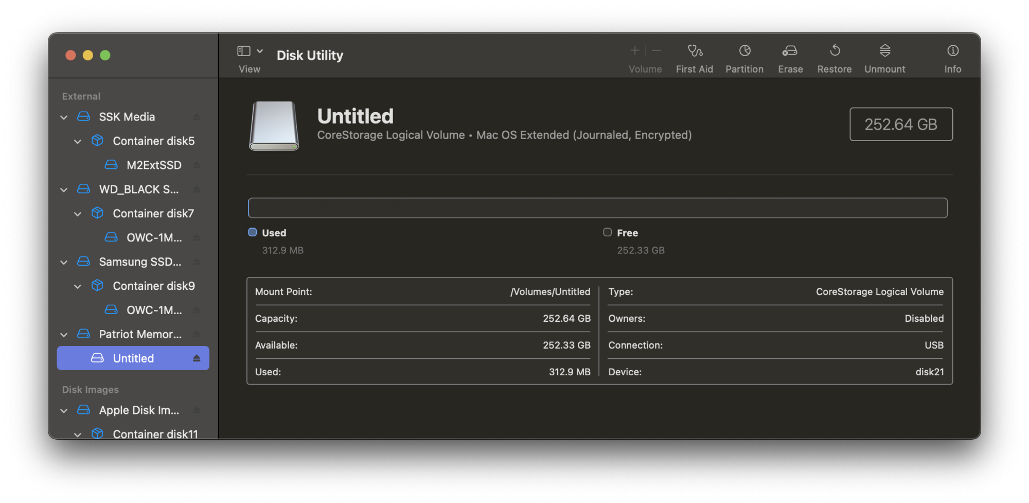

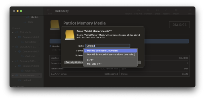

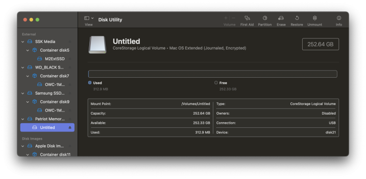

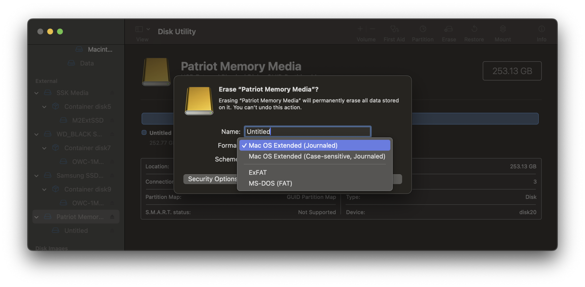

1. I assume, it’s the same 256-bit used currently. Mac OS X 10.7 Lion was the first to include FileVault 2, which is still the current version.
2. Yes, although, the cutoff could be Mac OS X Lion due to the above. Coincidentally, I was able to do a test using Mac OS X Lion on a MacBook (Mid-2007) with a 256GB Patriot Rage 2 thumb drive. The drive mounted no problem on my M4 Mac mini with the latest version of macOS Sequoia.
3. I can’t test the encrypted aspect from newer to older as it appears HFS+ Encrypted has been deprecated in recent versions of Disk Utility. That fact also helps verify I did the erase and format on an older Mac OS version.

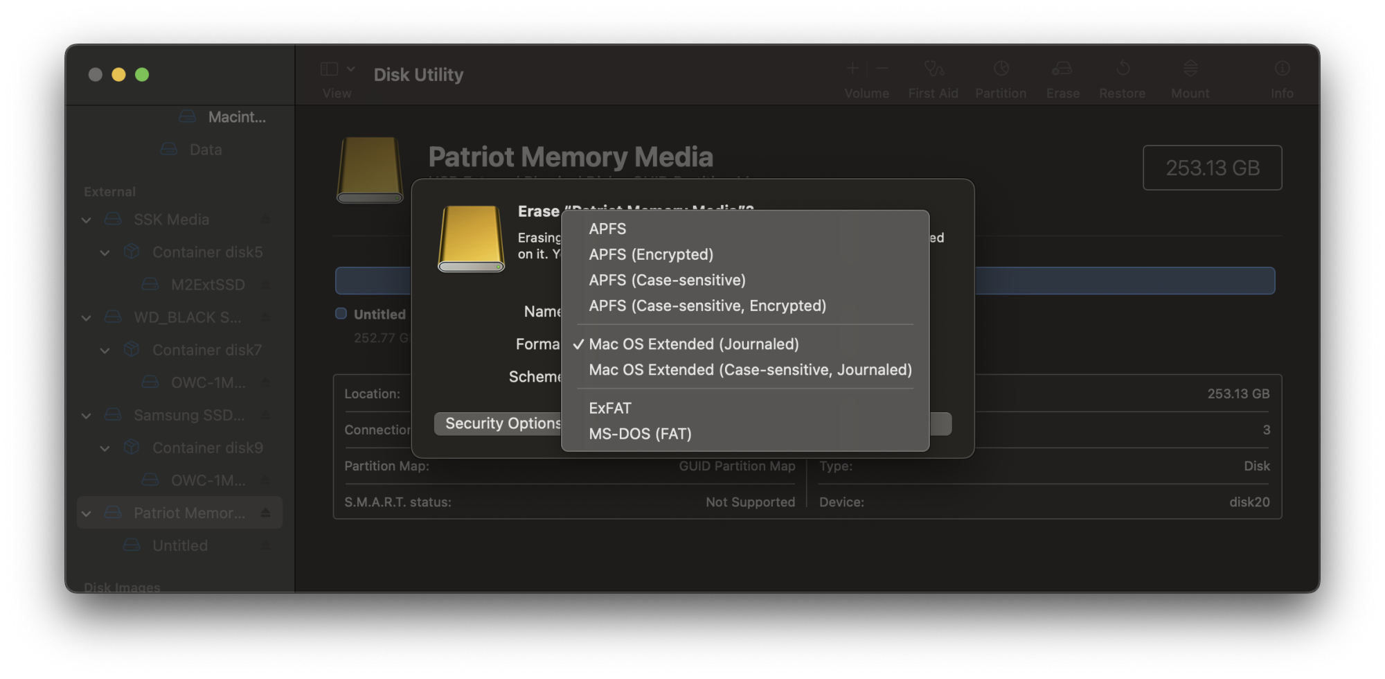

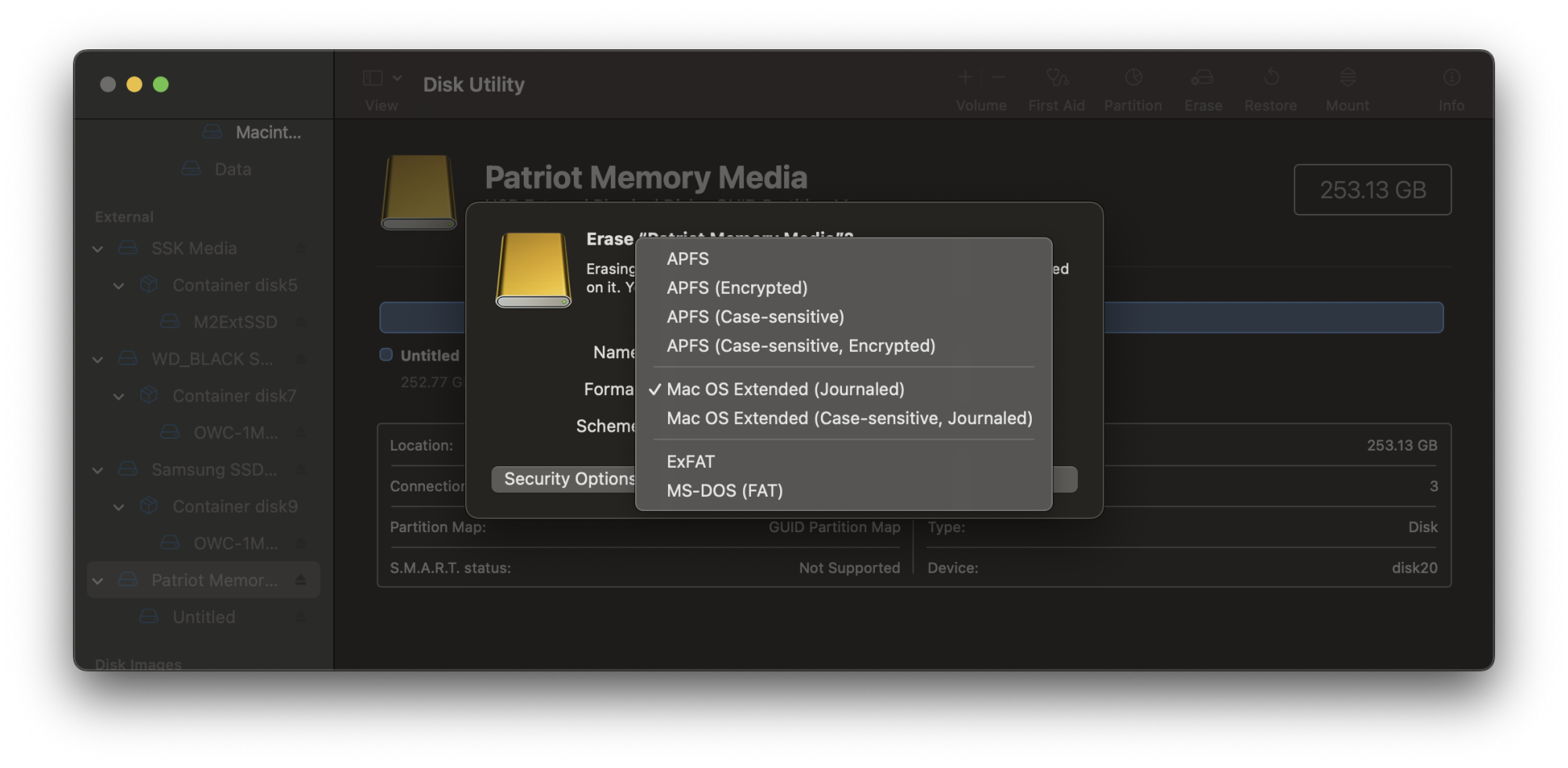

Last question (until the next one😉) - for future compatibility, should I format the USB drives with APFS (it is an option on the 2011 machine) or will Mac OS Extended (Journaled) be okay?
I would strongly recommend switching to APFS as soon as possible. Apple’s not one to hang onto legacy for long, and APFS has been the standard since macOS 10.15 Catalina. Lastly, even though the HFS+ Encrypted drive seemed to function smoothly in Finder, Disk Utility (in Sequoia) was very grumpy (i.e., mostly pinwheeled err beach balled) when asked to deal with it.
Thanks, I converted all my USB drives to APFS. When I erased the USB drives there was an option for APFS or APFS Encrypted and I chose the latter. When I created a disk image for the desktop, only the former format was available but there was an option elsewhere to encrypt. I don't think that's any issue, but just curious why the different options for USB drives and disk images.
