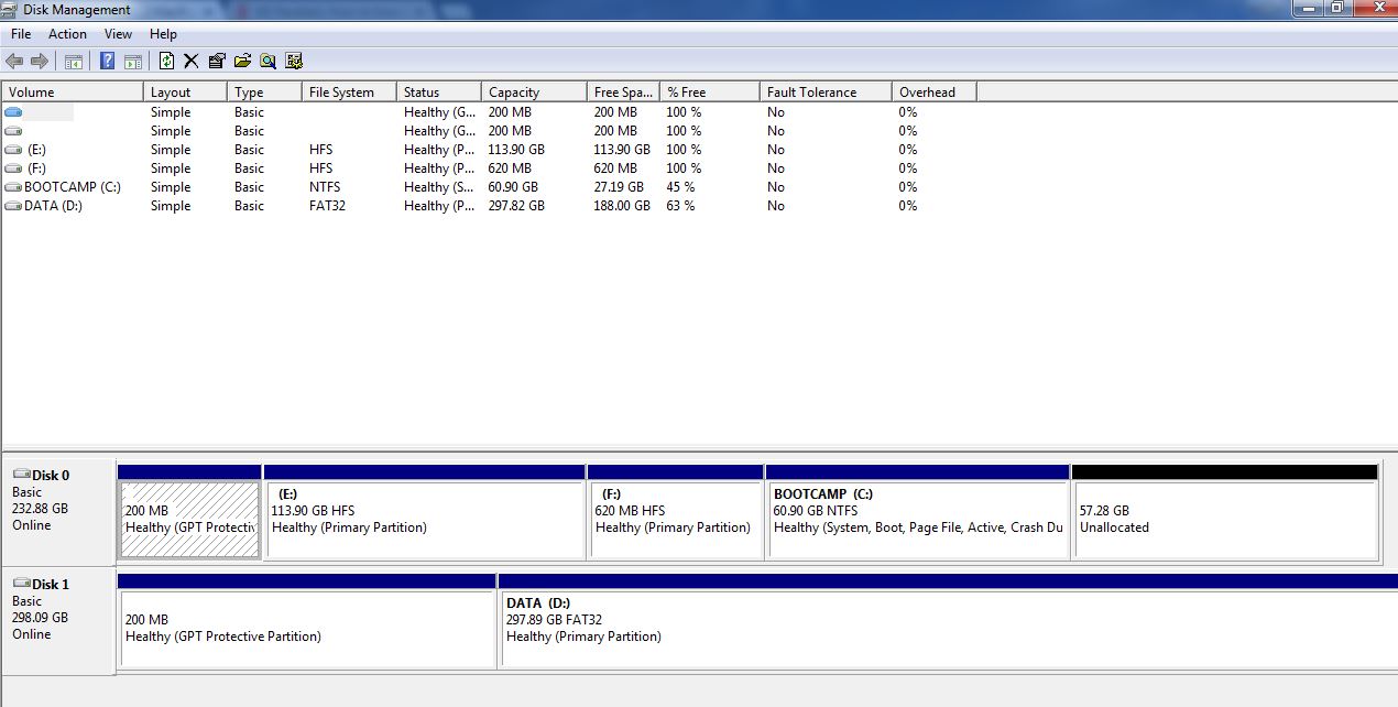

These are my partitions when viewed in W7.
The unallocated space in the end is the EXT4 Linux partition which Windows can't read so it thinks it's unallocated space.
