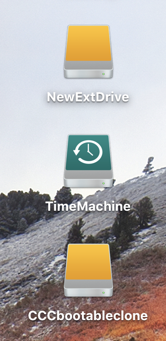

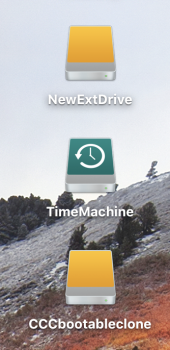

I have a Western Digital 2TB My Passport external drive connected via USB to my iMac. I partitioned the drive to include external backup, my TimeMachine backup, and by Carbon Copy Cloner bootable backups. Works perfectly.
Occasionally when I shut down my iMac, the external drive light stays on steadily or blinks and the darkened screen gets caught in an endless spinning loop.
What am I doing wrong? Do I need to eject the external drive every time before shutting down? If I need to do that, do I drag a drive icon to the trash, and if so, which one?

My thoughts only, but your CCC cloned backup should be on its own "physical drive", separate and apart from a drive that contains TM backups.
I don't use TM at all (CCC for ALL my backups).
I've even gone so far as to delete the TM app from my Mac, as well as the TM preference pane in System preferences....!
OK, Fishrrman, now I'm really curious. Why do you think the CCC cloned backup needs to be on its own physical drive apart from a drive that contains TM backups?
Also, what's your beef with TM?
