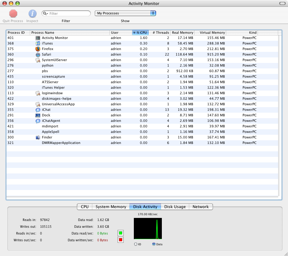

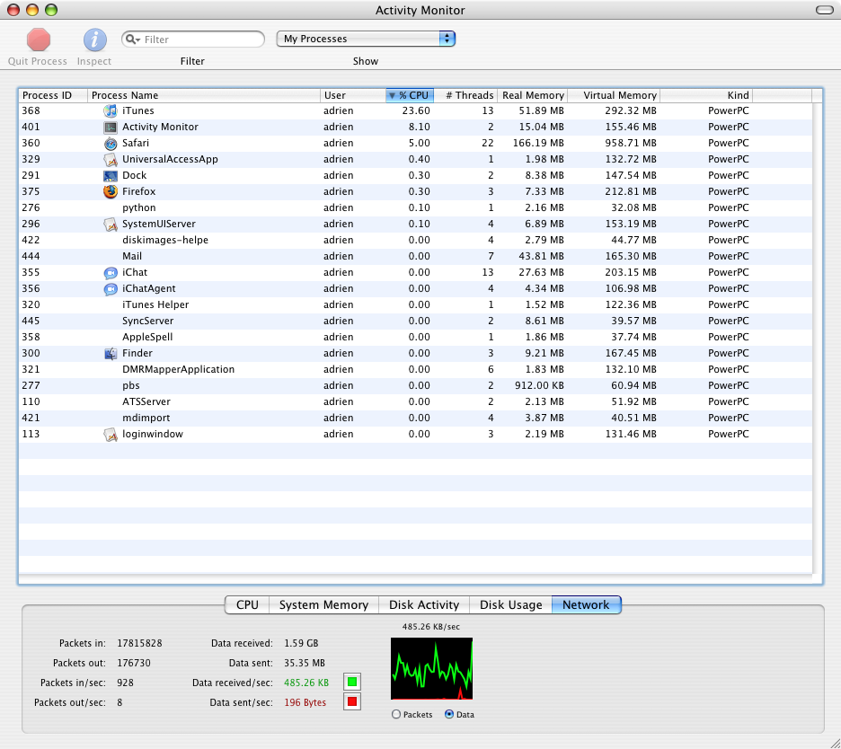

I have no idea what is going on with my computer. It is constantly downloading something, from somewhere, apparently without saving it to the hard drive or anything (no HD activity), with no applications open.
It seems to be running pretty much at the max speed of my internet (college internet speed varies depending on the time of day), so it can be anywhere from 300 KB/s to more than 1 MB/s (my computer hates that).
It comes back after restarting, though I haven't observed it closely enough to see exactly how/when it comes back. It's there whether or not I have apps open. It seems to be generating anywhere from 10-30% processor use as well, depending on how fast it's going.
Gahhhhhhhhhhhhhh! 🙄

i have that same problem, except that i am uploading stuff as well. i am also on a college network. But they have the internet here locked down so tight its not even funny so i don't think its some computer out there. I've looked under windows and it is not downloading anything. Here's a pic.

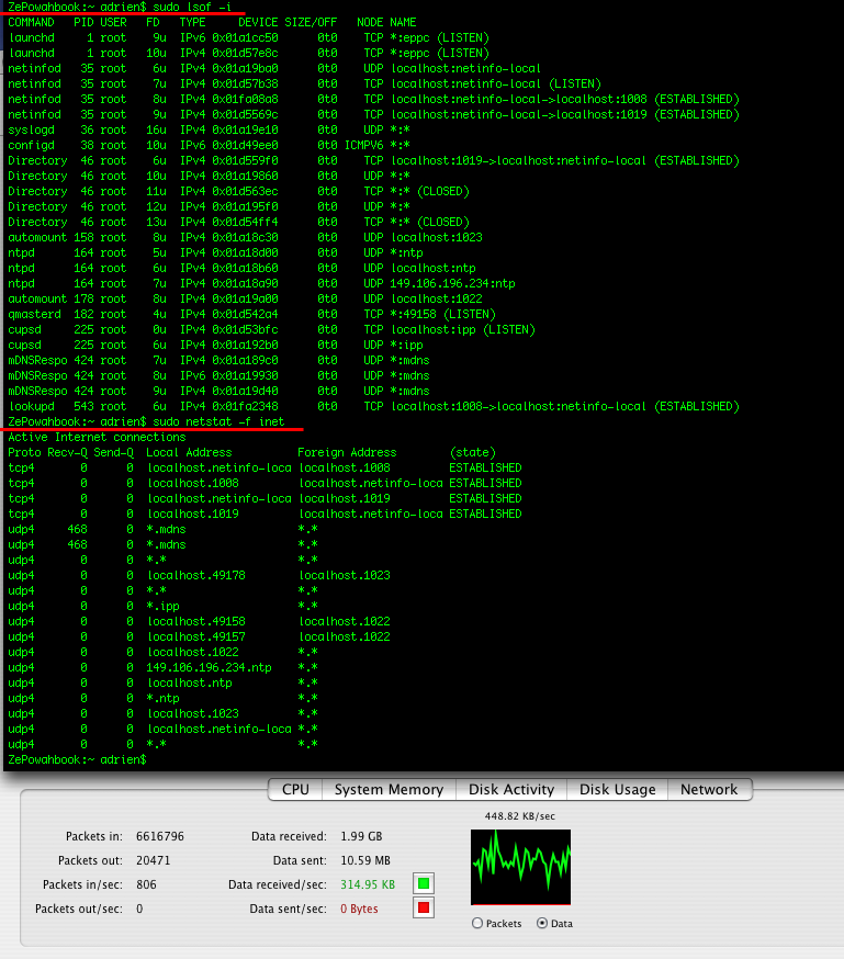

In Network Utility, you can use Netstat. (the netstat command is also available from the terminal, try netstat -f inet to trim the output to the generally interesting parts)
Also from terminal, lsof -i can give an interesting view of what is connecting where. Prefix that with sudo (password prompt will follow) to see everything, not just your own processes.

I've attached my netstat results, which seem to show activity under the processes "*.mdns", which seem to be receiving something constantly. I tried force-quitting the mDNSResponder process in the terminal (which, incidentally uses a significant amount of processor), which caused the network activity to spike suddenly and then drop off to 0 for just a moment before the process came back. I'm pretty sure that that's the problem...but what is it doing, and how do I fix it?

I ran lsof and netstat at the same time, with no apps open other than activity monitor and the terminal, but I'm not sure how to interpret the results (attached). Note the disproportion between the upload and download/packets in/out totals in the activity monitor.
