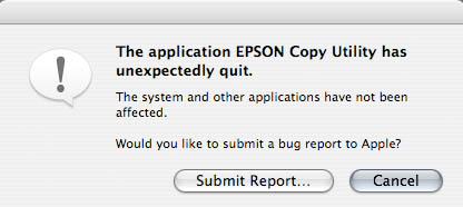

I have a Epson 3170, I have never been able to get the smart pannel function to work, other than the scan & save. I would like to the the Start button on the scanner work as the copy center. but every time i run the app it quits. in fact the only epson app i can get to work is Epson Scan. I sent epson a few detailed emails with crash logs but got no reply. The scanner is very good but i am not impressed by the software or customer service.

Re: Epson 3200 Scanner and 10.3
Check either their website or Newsoft. They've recently posted a new patch to SmartPanel that seems to work.
Also check permissions of your Colorsync and InputDevice files. Make sure you have read/write permissions. it bit me in that the scanner would work from my login, but not from anyone else's on my computer.
i have resolved my problem... though it was a while ago that i had.....
i called epson and only had to pay for long distance (though i do not pay for long distance), the call was free because my scanner was purchased less then a year ago.
as i recall: epson scan to file does not work with 10.3.3. Instead epson relies on their epson scan and their epson scan monitor for this. you can select a scan to file option through these programs, and use the image capture program to designate the function of the epson button the scanner.
i believe as well there is a scan to print option??? not sure.
anyway, there apparently was a conflict between epson scan and epson scan to file softwares.
the procedure was to clear out all related files to epson scan to file, do a clean install of epson scan, and everything worked. (as i remember, it was several weeks ago)
r.
