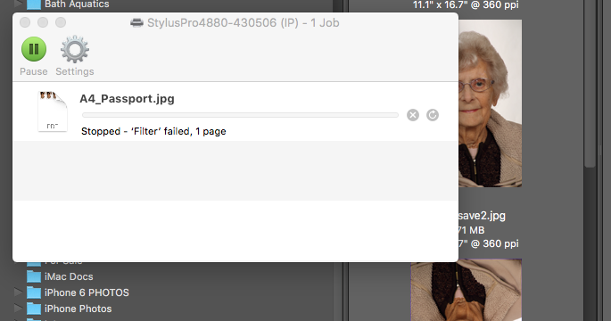

I have 4 printers, 2 of them are Epson. Neither work now, as of a couple of days ago. I initially put that down to latest OS High Sierra. But dont think its that, I think its a virus or malware. Ive installed Sophos and Malwarebites (too late!). Both come up with no reported problems. My main concern it the pro-4880. That was running via USB, but also tried network now. Ive removed the printers in settings and even done a complete wipe of the printers. It will run a head test, but thats about it. The little A4 printer was reporting the same fail, but now simply fails to print. Ive got the latest driver (its quite old though!) I rang Epson, they think its a type of virus, but quoted £169 to help me fix it, which I simply cannot afford. I'm not even convinced that they would be able to help me.
Ive run out of ideas! Any help much appreciated. Martin

to answer in order......The head test was sent from the Mac. Not via the panel on the printer. There are no error lights or message on the panel itself.
Ive tried sending via USB and also Network to. NO LUCK!
I did google it, but to be honest, that didn't come up with any answers at all.

Ive run disk utility and also the diagnostic tool (the one where you do on booting) this morning. No reports of faults at all. just tested the printer again, and still nothing. same error message. All I can think is that the driver for the 4880, isn't working with the latest OS.
