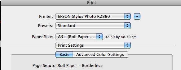

I was just about ready to print but have run into a dilemma.
In print settings, the paper is showing up as a width of 482mm. My document is 1200mm. Is there a limit to the paper size/document size?
I don't want to print out half the document because the paper is fairly expensive...
Thank You
Thank You
When you are in Print Settings and you can choose your Paper Size, go to the bottom and select Manage Custom Sizes. From there, you can make it any size you want. You should then be able to see a preview on the Print dialog box with your image and new paper size to make sure it fits how you like it.

I have a similar problem. When I select the 13"x19" printer option with my roll paper and then try to print something 24" long it truncates it at 19" -- nowhere do I find an explanation of how to print something longer than 19"... Help?
