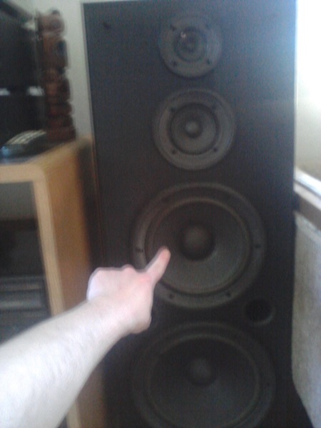

I really wanted to do it as cheaply as possible. The speakers are the same, the issue is with the smaller woofer on the left speaker, which has died. I just wan't to compensate by lowering the bass frequencies on the right side a bit.

"Smaller woofer" What is THAT?
Do you mean that the tweeter on one side is blown out and you want to kill the highs on the other side?
If the problem is the blown tweeter, replace it. Likey cost under $10 at PartsExpress.
If you want to adjust the bass move the speaker close to a wall to bost it and about 2+ feet from the wall to reduce it. Also to cut or boost treble you can aid the speakers, away to reduce it and to you to boost it.
You are going to have to explain "Smaller woofer".

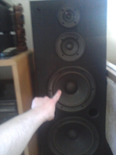

I wasn't concerned enough to measure the smaller woofer and didn't want to make a wrong guess at the size.....is it an eight inch woofer?
attachment.php
Open the "good" speaker and pull the lead wires off the back of the "small woofer". Zero cost and then they will match. Normally they use push-on "fasted" type connectors that come off with no tools. You might have to remove a driver to gain access with your hands if the back is not removable
Then replace BOTH drivers. They don't cost much. Try a place like Parts Express.
Or...
Pull both drivers and send them to Orange County Speaker on So. California and have them re-code the blown out driver (using the good one as an example.) They can strip it down to the metal basket and rebuild it. Price is not as much as you might think.
