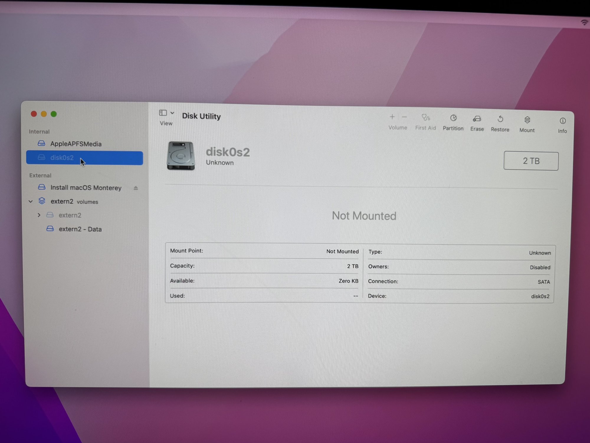

My trusty 27" iMac died last year and has been sitting since then for me to find the time to deal with it. Since it still powers on (and can boot from an external drive just fine), just can't boot from the fusion drive, I suspect it's the fusion drive that failed. Initially, I had hoped I'd still be able to safe my data off the HD portion, but upon repeated research, this seems to be neigh impossible. I'd even considered removing the drive before doing anything with the iMac itself (recycle?), but that of course is not straight forward with an iMac.
We now have a move in our near future and I'm wanting to put up the iMac for sale for parts or for someone to boot from an external drive. However, for obvious reasons I want to make sure all personal data was erased from the HD. In the disk utility, both drive portions still show up (but can't be mounted nor accessed). First aid and recovery failed and I'm reluctant to start "erase" in case it also doesn't work (or only partly) but then completely removes the drives from the disk utility. Since I can't access them, there's also no way for me to verify any data was actually indeed erased.

OP:
What happens if
You boot externally and open disk utility
then
Click on either the internal SSD portion (of the fusion drive) or the HDD portion
then
Click the "erase" button?
What do you see?
Do you have the option to erase it?
(you can still cancel out at this point if you wish).
Take a screenshot or phone pic and post it here so we can see what you see.

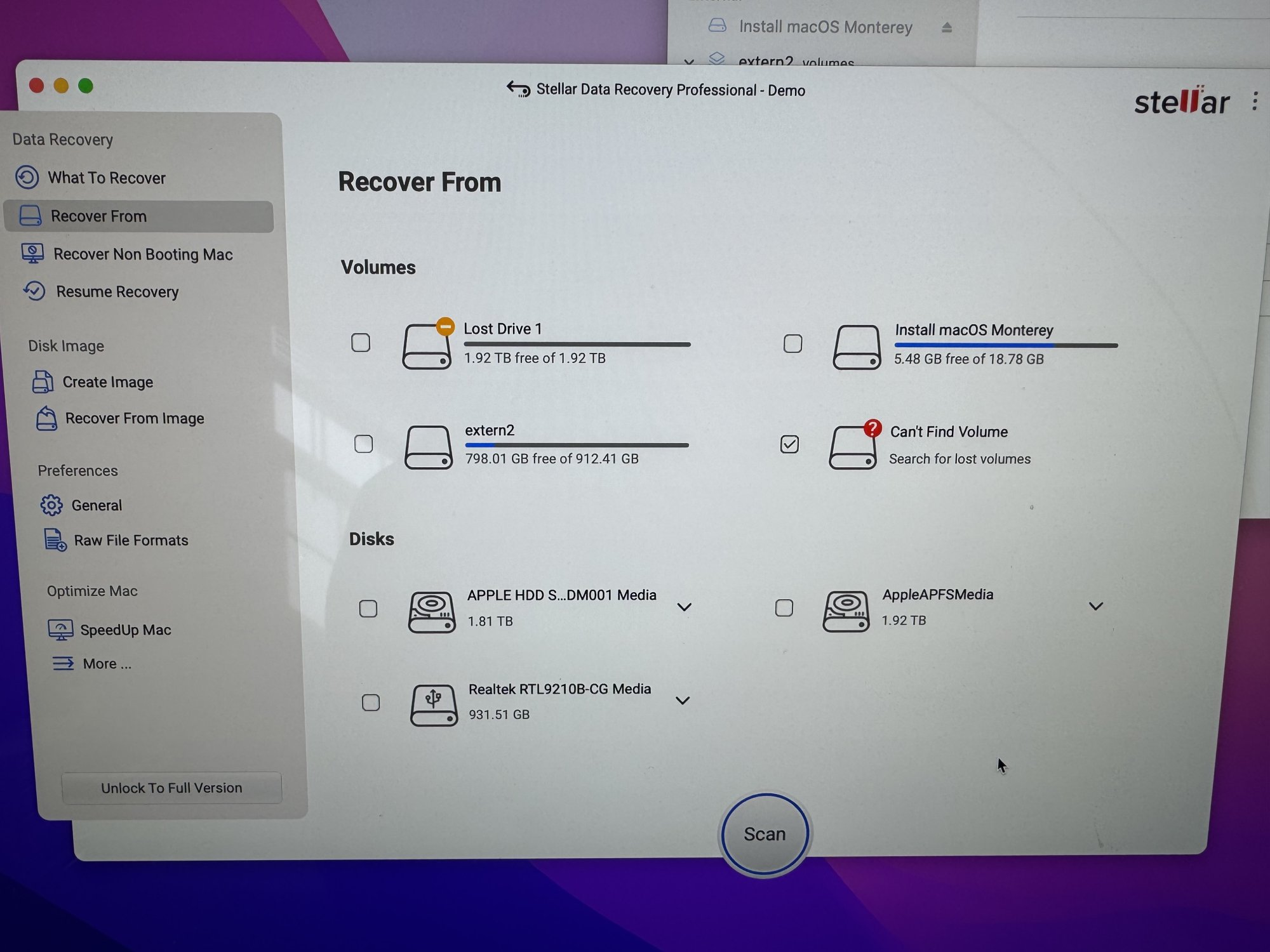

Since I posted, I also made one last attempt to recover some of the data with the Stellar Software following this thread. I've been running the demo version to see if it even is worth spending the $100. It does seem to find data, but I haven't gotten to the actual "recovery" part, yet. However, ever since I've done the scan, it changed the naming of the two internal hard drives. Before they were named something along the lines of "Macintosh HD" and "Macintosh HD - Data". This is what I see now in disk utility, as well as in the Stellar Software.

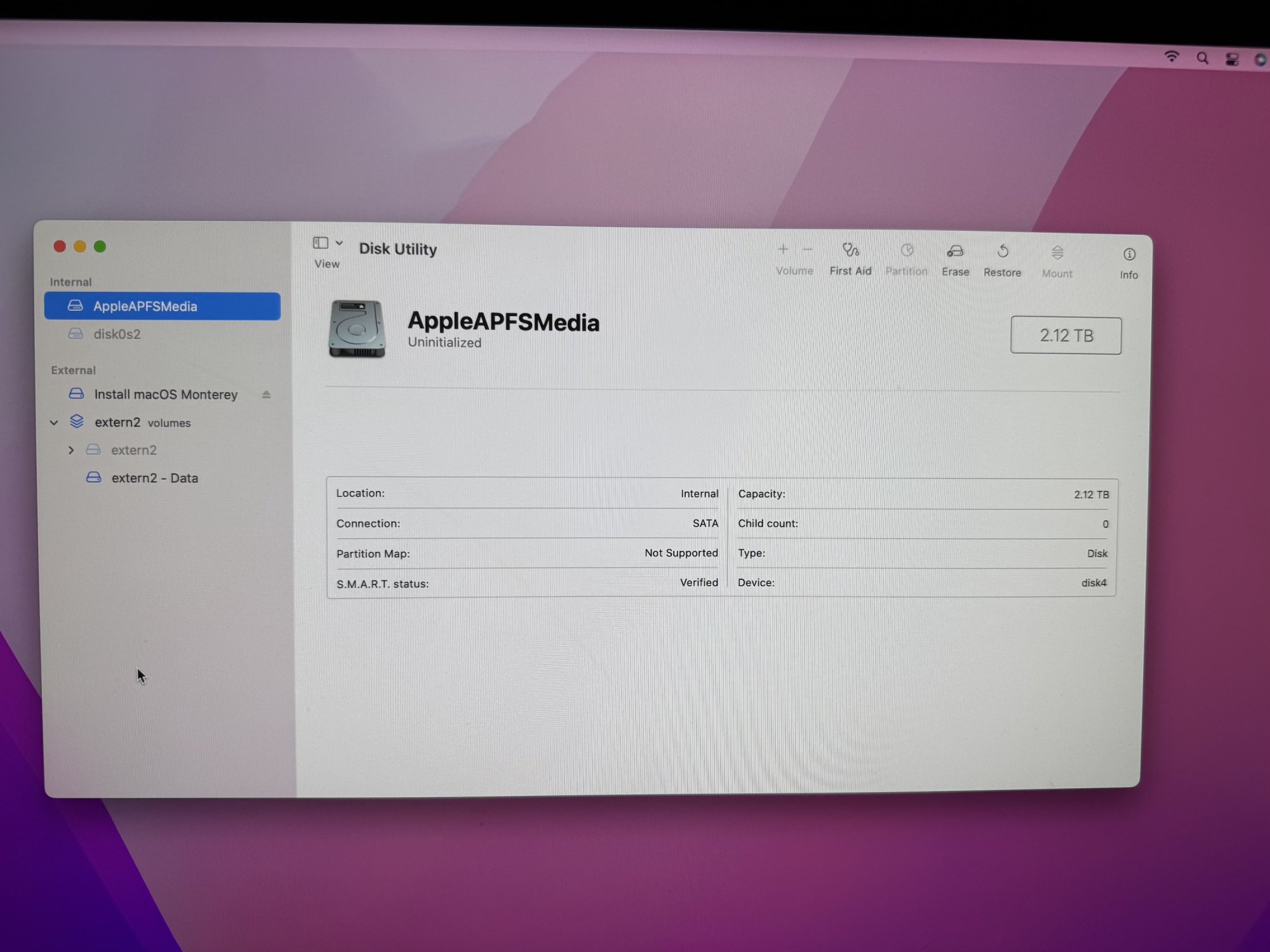

Try erasing both internal drives that we see in the first pic in your reply 9 above.

ERASE the drives.
I think I may have blown my chance for that. While booted from the external drive yesterday and being in standby, the iMac just randomly crashed, restarted and unsuccessfully tried to boot from the internal drive. The drives now no longer show up in disk utility. Guess I will have to open up the iMac and pull the drive, just for peace of mind.
