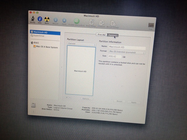

There's no way of creating a new partition as it says its a locked disk, and if I click on reinstall OS X it doesn't come up with a disk to install to.
Disk utility just comes up with (see photo)
I think you are going to need to boot from another partition of some sort, like a USB key... to get to that drive and reformat it. Do you have a Time Machine backup maybe you can boot to? Or a bootable USB key?
Do you have access to another Lion or Mountain Lion Mac you could use with this utility and a 1GB (or larger) USB key to make a bootable key.
Once you boot from the USB key, you should be able to select the drive (like 1TB Seagate or whatever) and erase the entire drive, then start over.
I think what you are seeing there is the remains of the encrypted core storage volume created by FV2.
As you have no doubt realized now, you should have unencrypted FV2 before you did this.

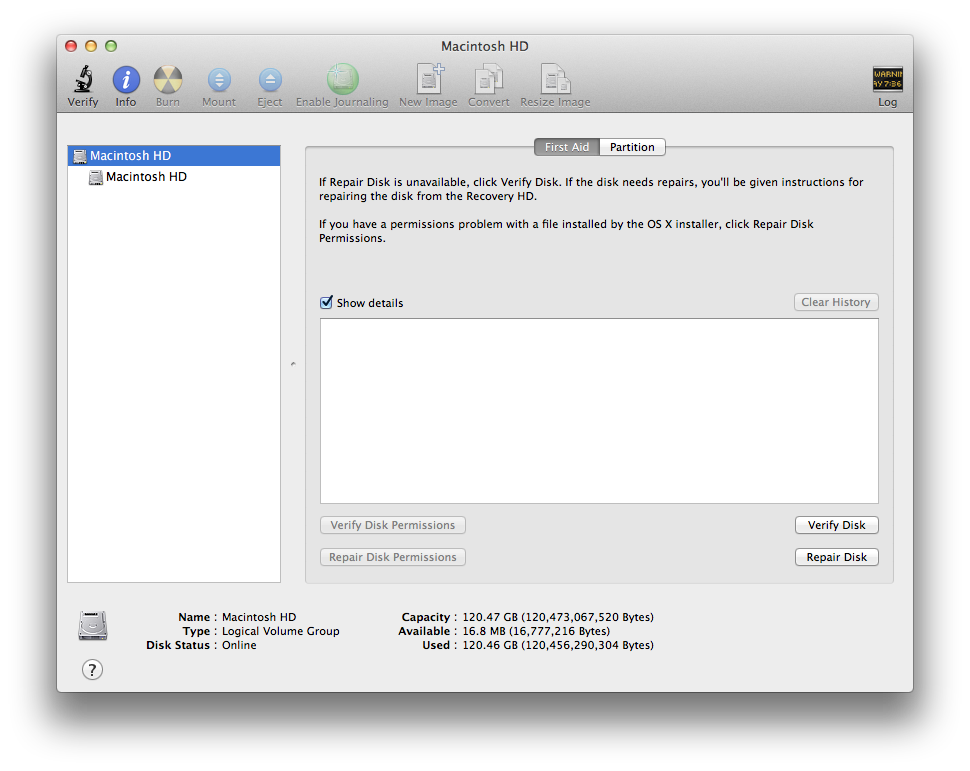

FV2 does something odd to the recovery partition that makes the entire drive look like a logical volume. This screenshot of DU on my system does not even show the physical drive.
