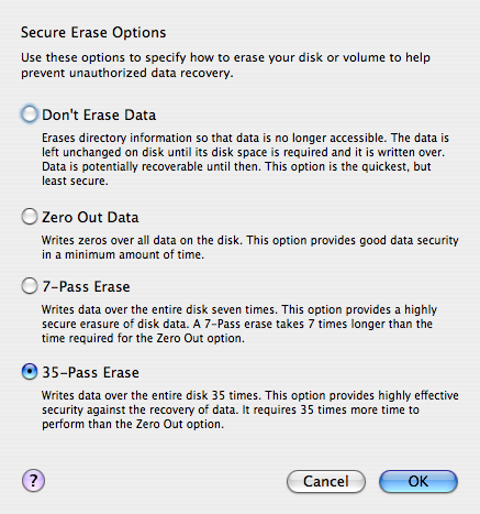

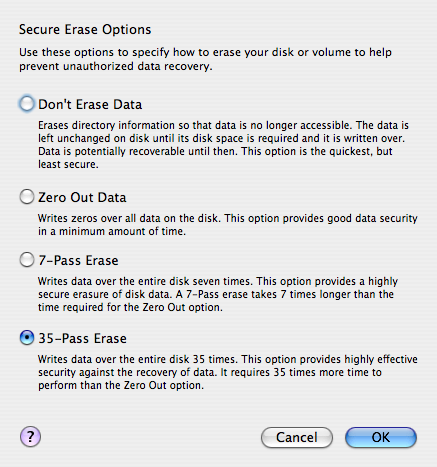

I've never tried it, but what about using Disk Utility? Choosing 35-Pass Erase should do a good job.
Just beware: This might take a while... 7 pass (or really just a clean zero out) should be enough for us normally to lightly paranoid... 😉
Mitthrawnuruodo said:
Just beware: This might take a while... 😉
Yeah.. zero-out would probably be enough unless you REALLY want to get rid of that goat pr0n or those secret Iraqi WMD documents.
Ya, it would probably take a lifetime. 😱
unless the new owner is a suicidal homicidal paedophile in denial who wants to recover everything on your HDD though any means he can, a 7-pass erase should be enough. 😛
7-pass should make it very difficult to recover anything. The new owner would have to actually try really hard to recover stuff. Unless I worked for a government agency or something like that, i wouldn't bother with a 30-pass write. Its just too big a waste of my time.

Remember, in order to do this you're not running anything from the HD, you should boot from your OS X Install Disc 1 and run the Disc Utility from there.
That way you will be able to complete a proper erase (of however many passes you like) of your hard drive.
I'd say "Zero-out data" should be sufficient, but if you really are worried then go for the "7-pass".
Enjoy.
