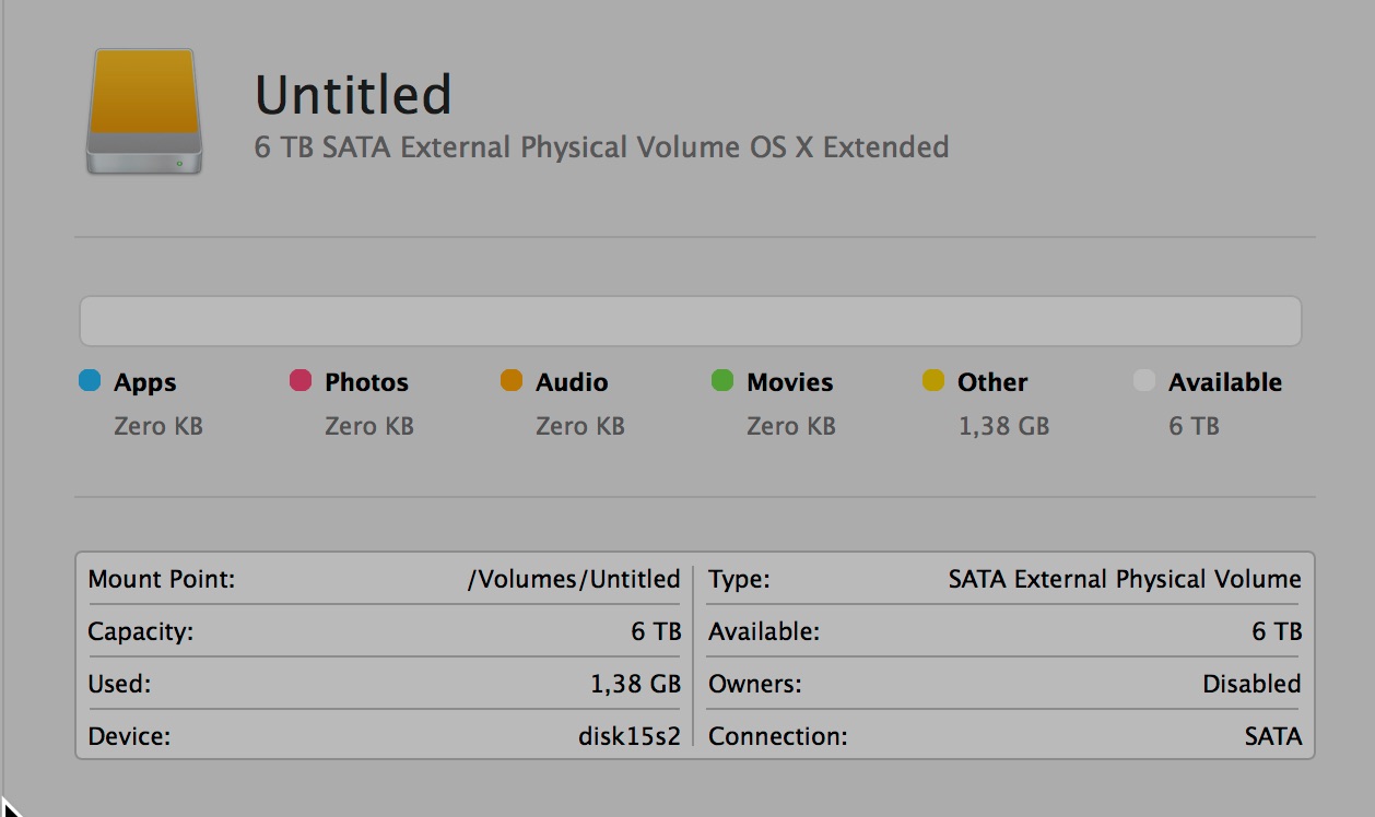

Erased an external previously used drive for another purpose.
Disk utility shows only one partition, ok
but it also shows I have 79 files left on the drive and tells
me I only have 95% of the drive capacity available.

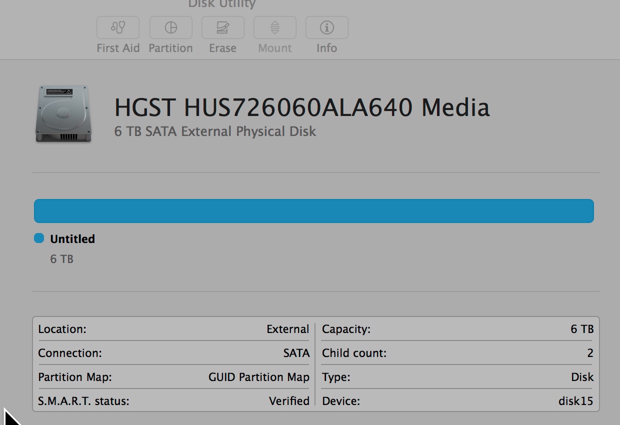

this is what I see, "Main" pic is the first line in disk utility, untitled is the blank formatted with GUID
[doublepost=1457183615][/doublepost]Deltamac,
I do erase from the device line, "HGST..." but still get the formatted "untitled" volume with 1,38 gigs missing
But then, it is only 1.38GB, out of 6TB, some .023% of the total available 😀

The 1.38 GB is most likely the inode table.

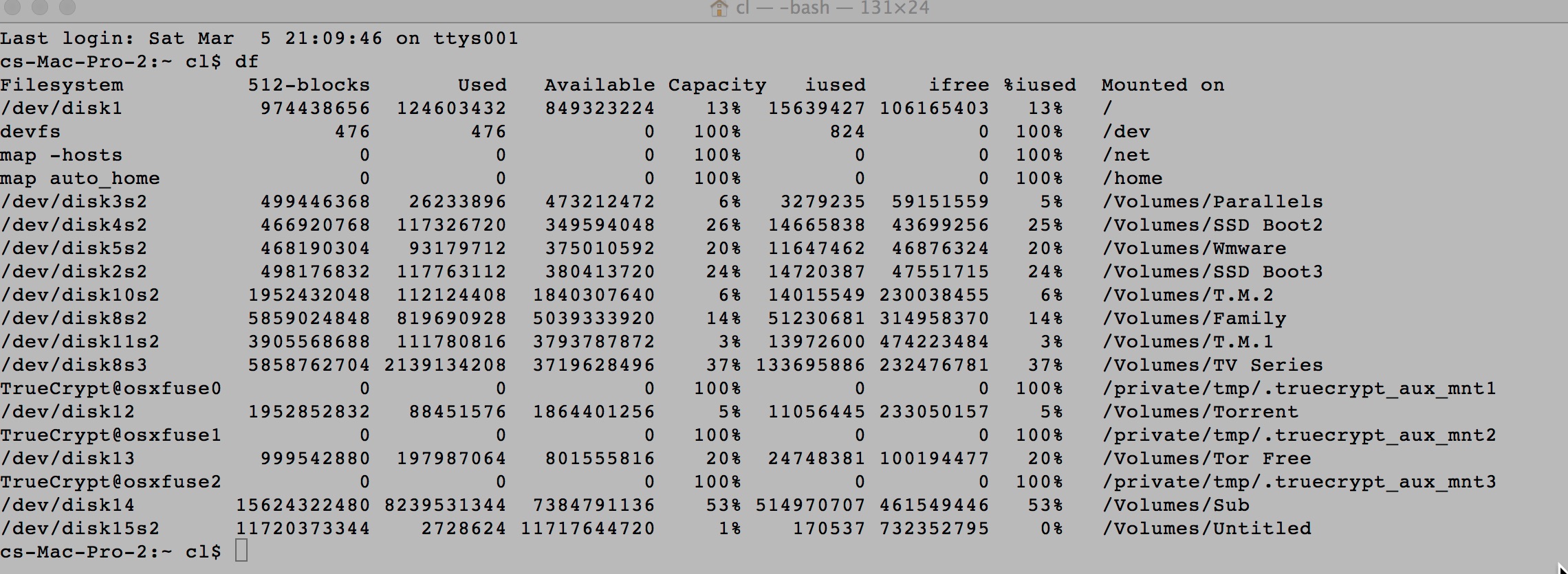

Do a df command in terminal. The iused, ifree and %iused columns display the inode information.

I would expect that a 6TB disk would have a very large number of inodes defined.

IowaLynn, Hi this is what df command gives out :

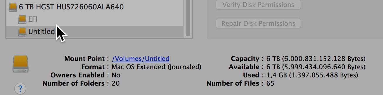

And this is what I find disturbing, these folders & files after a full format ... :

Post #8 is showing an older version of Disk Utility, not from El Cap.
@ilandmac - What happens in that version of Disk Utility, Select the device, then go to the Partitions tab?

You are right, I'm mostly using the Yosemite version of Disk Utility because the one in Capitan
is barely usable in my opinion. In this case I used both so as to be certain of these remaining
files.
I did do what you're suggesting, in all ways and manners that I could think of but to no avail.
So an OS X erase & reformat (in all its flavours) , where they tell you this will completely wipe
out a drive (short of the EFI issue of sorts..) is just not effective, to be polite.

Hi Sigsegv
Agreed eventually on the # of files, but I cannot see spotlight using 1,38 gig for this. That's like a lot on a supposedly empty drive...
Plus this info is gathered seconds after formatting.
Best
ilandmac
The spotlight index appears to be created instantly. I ran that only 2-3 seconds after the format.
The other overhead you might notice is the metadata zone:
https://developer.apple.com/legacy/library/technotes/tn/tn1150.html#MetadataZone
I haven't run the calculation but it's entirely plausible that 1,38 G is consumed there - possibly more when you look at the catalog and hot files. At the time that tech note was written (2004) they could account for up to 1.5% of space.
Apple may have tuned those ratios down a bit over the past 12 years now that we have multi-TB drives and multi-GB files.
Reactions: Weaselboy
