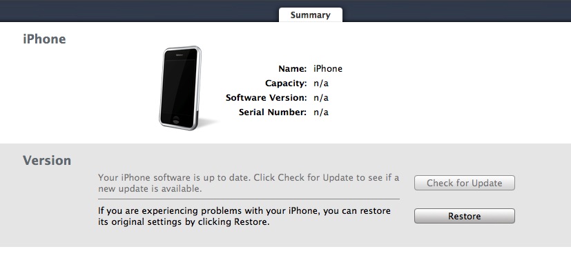

I also notice that iphone info don't show up. is that normal? thx.
it is normal. it is showing up like that because it is stuck in recovery mode!
