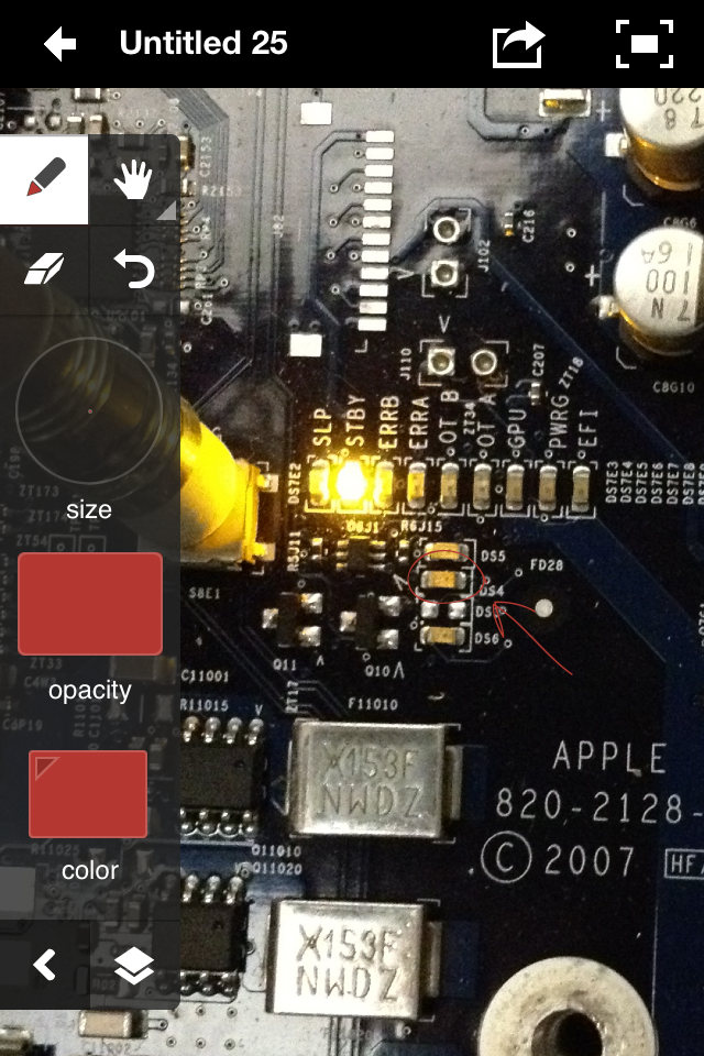

The problem now, is that the machine even turns on anymore. It ligh the power button, start the video card's fan, lighted the 4 red leds on each riser and shutted down, blinked once a yellow led number 054 on logicboard bellow the diagnoctics leds. If I hitted again the power button,mdid nothing. If I wait some seconds and press and hold again, turnned on leds 5 and 6 of diagnostics on logicboard and when released, turned on, including the fans stayed for about 5 sec and turned off again.

So, I opened the mac, disconnect video card, optical drive, both memory risers, unplugged and re-plugged all 4 connectors from power supply (P1, P2, P3 and D), unplugged and re-plugged the power cable from logic board behind the front fan and behind the lower memory riser. All the times has the same scenario. I hit the power button, it lighted up, start the fan of video card (when installed) and after 2-3 sec. shut itself down, then blink once a yellow light (054) just bellow the diagnostic LEDS. Someone knows what that light means? Cause I can't find anything about it on web. If I hold the power button, it is not turn on, but after some 5 sec., turn on LEDS 5 and 6 of diagnostics LEDS and if I release the power button and press it again, it turn on, start all fans, light all LEDS on risers and shut down after 3-5 sec.

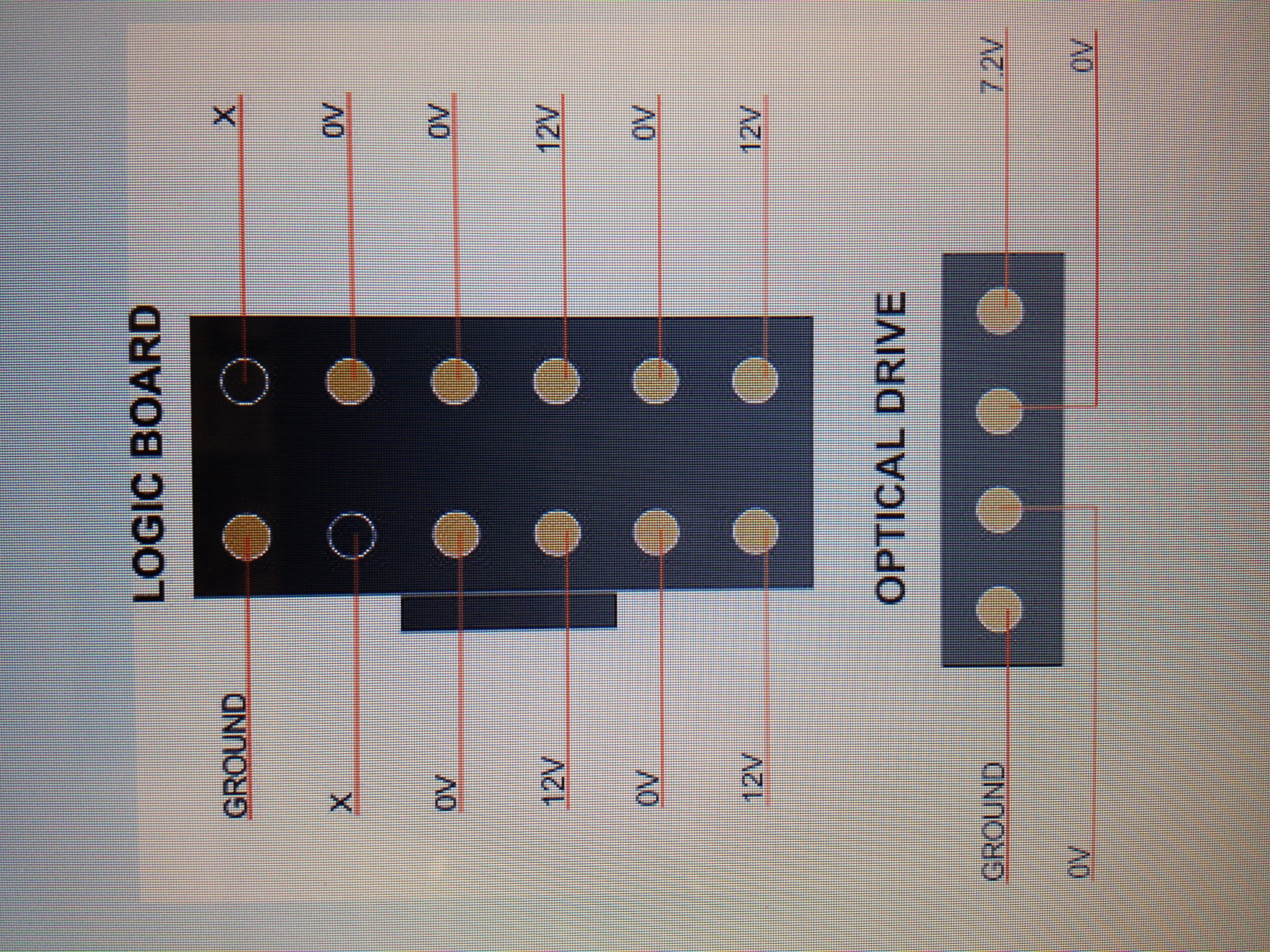

I tested if a multimeter, the plug that connect on logic board behind the front fan, and the one that connect on optical drive to test the PSU. I don't know if the results means and if it showed a bad PSU or if it confirms that the PSU is fine.
I'm post a diagram with the results, if someone wants to analyse it. regards.

Your pinouts are all wrong.
On the optical drive, it's +12V, GND, GND, +5V. Assuming you used the left most pin as ground, then your multimeter should have read about 7V on the right-most pin (the difference between +12V and +5V)- so I think that's OK.
The logic board has more then 1 power connector- there's 4 of them behind the optical drive bay, which merge into a harness that runs down the front of the machine and connects to the logic board in 6 or 7 different places all around the machine.
Please check your PM for further details.
