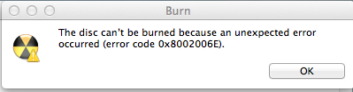

Aaaaaaaaaaaaaaaaaagh!!!!!!
I am SOOOOO sick of reading forum after forum after forum after forum saying change your media, xxxx is a bad make, delete your plist file, reboot it, reinstall the OS, boot from external and repair permissions on the internal, etc etc etc etc etc etc. NONE of this works here and Apple are clutching at straws and throwing out red herrings to keep people busy while they ignore this damn problem.
I have had this problem for months, it began JUST after my warranty expired on my 27" iMac i5. I was burning discs daily for a year, perfectly.
Some say its a faulty superdrive. So how come my external brand new LG burner i got the other day is doing the exact same thing. Weirdly, around the same time, iDVD changed. It used to burn in around 3-4 hours, in hundreds of cases, never longer than 5 hours. Suddenly, it says it needs 38 hours to burn a 1GB AVI file. Thats ridiculous, so clearly this is not hardware, its software.
I bought THREE new burning programs, every one of them run for hours, getting my hopes up, only to fail at the burning stage with either drive.
I have tried every brand of discs you can buy.
One thing I haven't tried is strangling someone on the alleged "Genius Bar". They may as well be at the "bar" for all the good they are with this problem!
If anyone has any REAL ideas of what might be causing this, I am all ears 🙂

"I have tried every brand of discs you can buy. "..... its got nothing to do with the brand of disc you're buying. are you burning a DATA disc or a playable dvd? im guessing data disc. drag the file into onto the disc icon and hit burn. make sure the highest burn speed is selected. you shouldnt need to purchase additional software to make this happen. I've gotten those errors before and even though it says the disc failed. I popped the disc right back in to see that it's been burned properly despite the warning. so if you've tried to burn it with your mac, and then tried burning it with multiple softwares, and it continuously fails, that might be a hint that your computer is failing. how old is it? it could be dying.
Also, I used to burn MOV and AVI files to discs YEARS ago... and now I try to insert them into the computer. and its spins really fast, and the computer refuses to let me view the file if the disc even manages to mount. I think the only way I was able to mount REALLY old burned dvds was through an external burner (a Lacie BluRay burner plugged into the computer via USB).... so theres a good chance that this disc you're burning wont work a few years down the line.... if you're doing this burn for archival purposes, i'd recommend putting the file on a hard drive. not a disc
