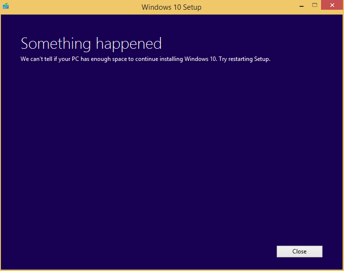

I keep getting this error when trying to upgrade Windows 8.1 on my 2013 Mac Pro.
Here is a summary:
1. Apple Software Update did not show the Bootcamp 6 update, so I used the Bootcamp Assistant on OS X and it downloaded Bootcamp 6 onto a USB stick. I then used this in Windows to upgrade bootcamp. Looking at Programs and Features, I appear to have BC 6 installed.
2. I tried to use the normal download method twice and both times it came back with the same error 8007001F. I know there is another thread on this error, but I have managed to get past it (point 3)
3. I then downloaded the ISO and the USB DVD media tool to create a USB flash drive. I cannot boot from it, but when I run setup.exe I get as far as the "not enough space" error and cannot continue.
4. I have searched and followed the various suggestions, like using Trouble Shooting in Control Panel, running chkdsk /b, running Disk Clean up and so forth
I am out of ideas. Has anybody encountered this on a Mac and managed to get past it? I see some people dual booting PCs with Linux have this issue, but their solutions do not seem viable on a Mac.

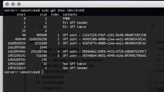

5 popped up after I upgraded to Windows 10. Doing some research it is the Windows 10 recovery partition
I don't think that gdisk gives any extra info over the built-in gpt, so I am including the output of gpt
The partition table is corrupt. Partition 5 should not be there and there may be other inconsistencies as well. Here you see a valid partition table with W10 installed. No such a thing as a Windows recovery partition. Loop back to my posting #20 in this thread.

According to technet DE94BBA4-06D1-4D40-A16A-BFD50179D6AC (5) is the Windows recovery partition.
https://technet.microsoft.com/en-us/library/ff715563.aspx
It only appeared when I upgraded the clean install of Windows 8 to Windows 10.
