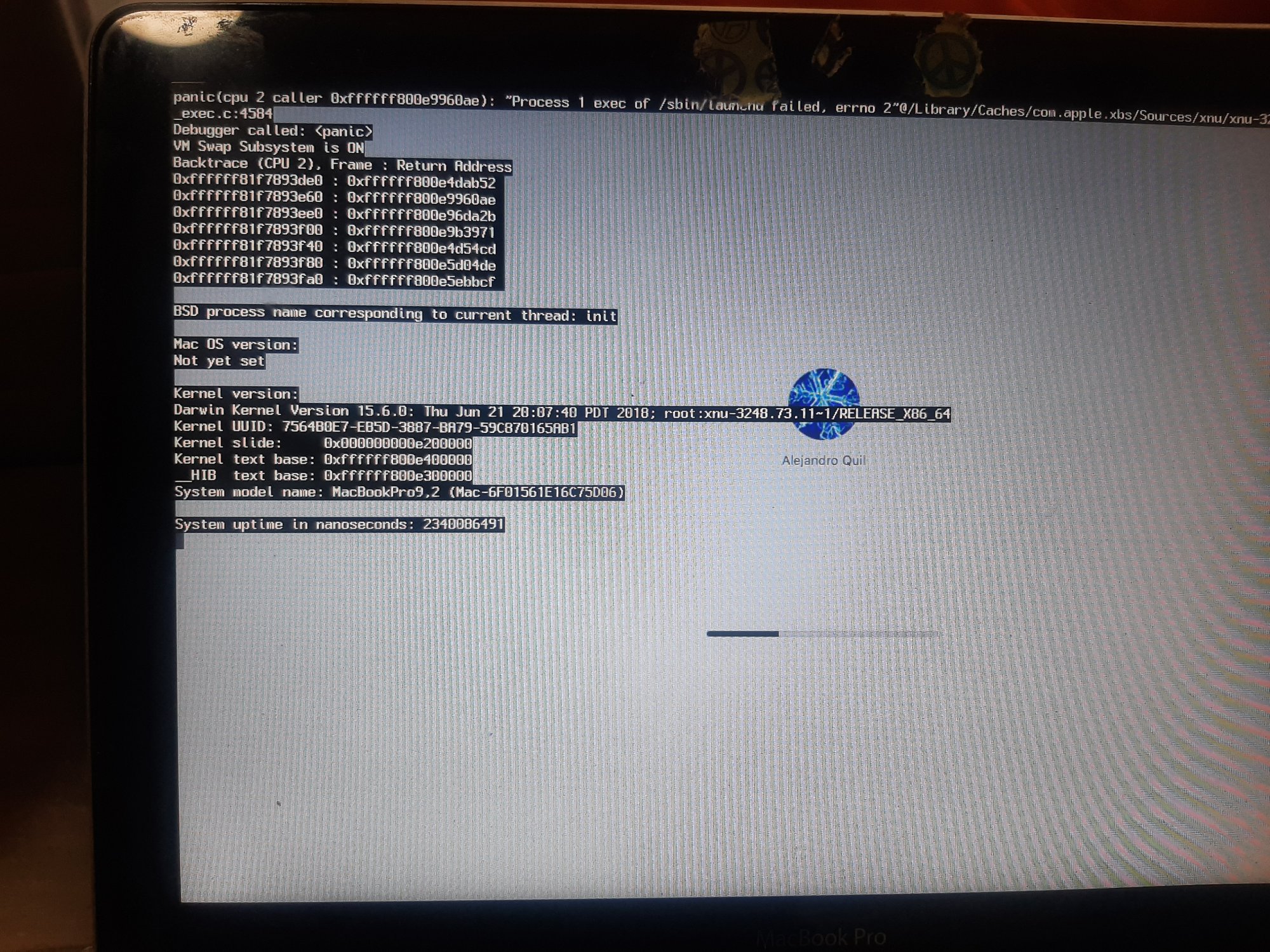

You can definitely try booting from a Linux Live USB or similar to transfer important data off before reinstalling. (And, make sure to set up Time Machine next time!)
You would have been running OS X 10.11.6 (El Capitan), so you can try booting to the recovery system, where you could reinstall the system you presently have. You can also try using Disk Utility, to run First Aid on the hard drive (might help) -- But, yes, Wowfunhappy has a good idea to do first, if there are important files on that 2012 MacBook Pro, and you don't have any backup of those files.
Do you know if the drive is an old hard drive (with a spinning disk), or do you know if the original hard drive has ever been replaced with an SSD? This would be the time to swap out an old hard drive to an SSD, as the old drive may be close to failure

Before an Erase and Reinstall, would it not be possible to put the Mac in Target Disk Mode and then grab the data off the drive? Or do you guys see something in the picture that says this Mac cannot do TDM?
I mean, at least if OP could copy the data off that before wiping the drive, that'd be a good thing I think.
