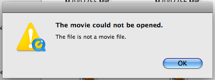

acearchie macrumors 68040 Original poster Apr 25, 2009 #1 Ok so I have several clips from a friends video camera in .mpg but they will not play in quicktime. They work perfectly in VLC but refuse to work in quicktime. Is this something wrong with the way the camera is encoding the .mpg? Thanks Attachments Picture 2.png 18.2 KB · Views: 126

J jackerin macrumors 6502a Apr 25, 2009 #2 They are most likely MPEG-2, which Quicktime will not play out-of-the-box. You can get the Quicktime MPEG-2 component (about 20 USD, iirc) or encode it to a format that you can play, like MPEG-4.
