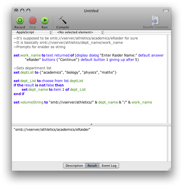

set volumeString to "smb://vserver/athletics/" & dept_name & "/" & work_name
mount volume is found in the StandardAdditions dictionary. I doesn't need a tell "Finder" block.

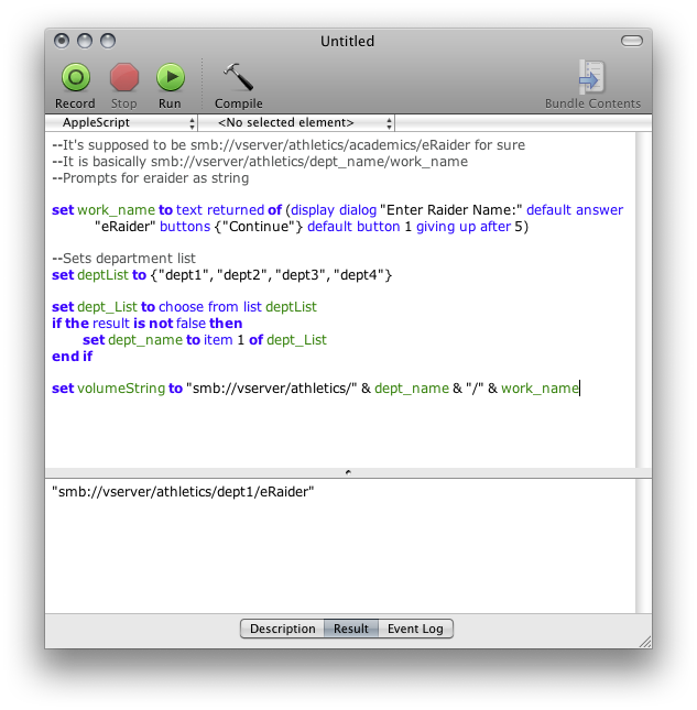

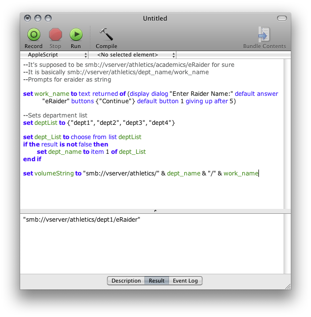

when trying this it doesn't mount the server. And after looking in the logs, it returns the wrong dept_name in the server path.

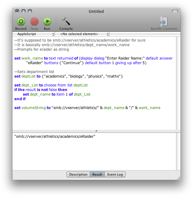

What did you set in your list? From your code :
Code:
--Sets department list
set deptList to {"dept1", "dept2", "dept3", "dept4"}
I didn't point it out because I wanted you to spot it. If you want it to be academics you should set it. eg
Code:
set deptList to {"academics", "biology", "physics", "maths"}
Code:
Code:
