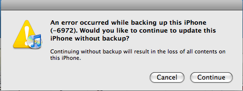

I too had this problem with the error "(-6972)". I have no idea what to do, and obviously don't want to lose all of my information. I'm starting to think this problem may be stemming from the fact that my phone is jailbroken. Maybe I'll save all of my contact information and everything and just allow it to update without backup.
