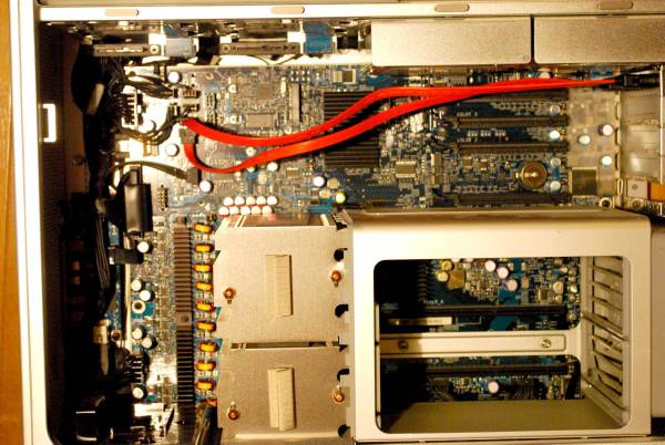

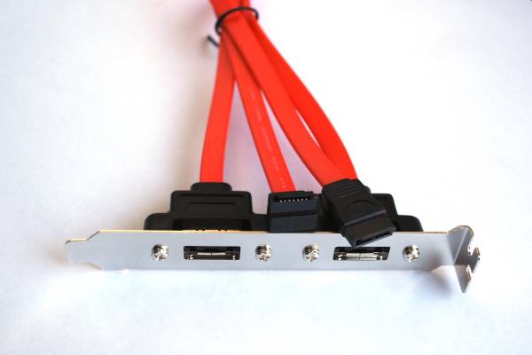

Do you even need a card? What's this (see attachments)? It seems to me there are already two extra ports. No?
It's a port extender to use the two unused SATA ports on the motherboards of pre-2009 Mac Pros. The problem is the ports won't be hot-swappable like true eSATA. Unplugging your external drive while the machine's running would be like pulling out an internal hard drive -- very bad.

That Macenstein article is talking about the Newertech port extender. Drives on it won't be hot swappable. The port extender isn't true eSATA regardless of what the product is named. A true eSATA card like the E2P supports hot-swapping.
