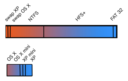

A less funky option might be to create different OS's for "stationary"-use and "on the go"-use.
The "On the go" have "everything else" on the faster external drive; programs, files, swap-partition.
This leaves the MBP with some space loss due to having 6 partitions then, two with complete installs, two with swap/pagefile, and two with just the slimed OS only.
That hurts when my internal disk is just 80GB :/
Would'nt this give a bit better performance? Better than the internal at least?
For sure it does not feel like a mac solution... 😉
Hm, that got complicated.
What I meant was 4 partitions on the internal and 4 partitions on the eSATA.
For stationary use I boot from the slim installs who have its content and swap on eSATA.
The FAT32 part is just for shared folders between XP and OS X
