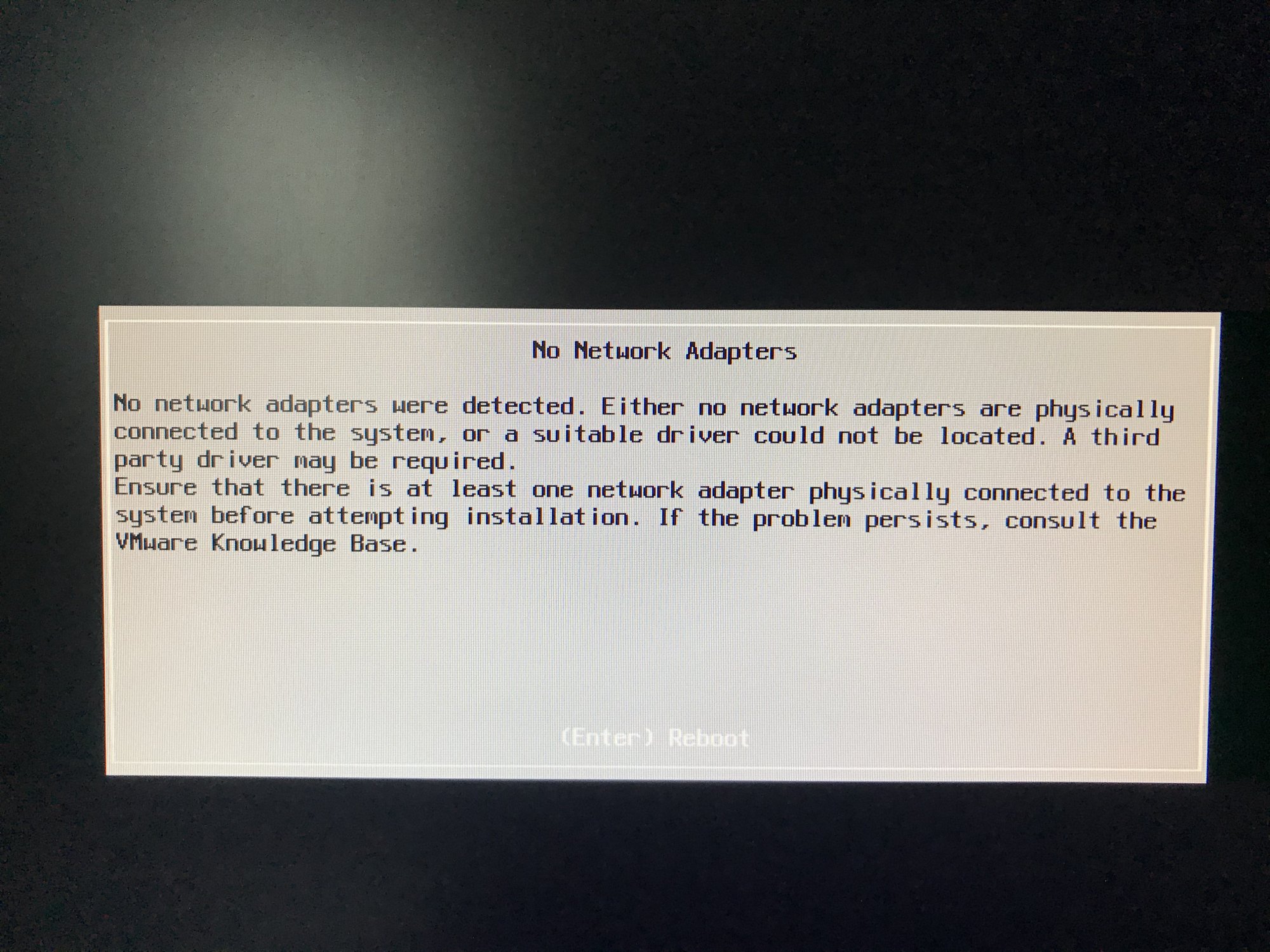

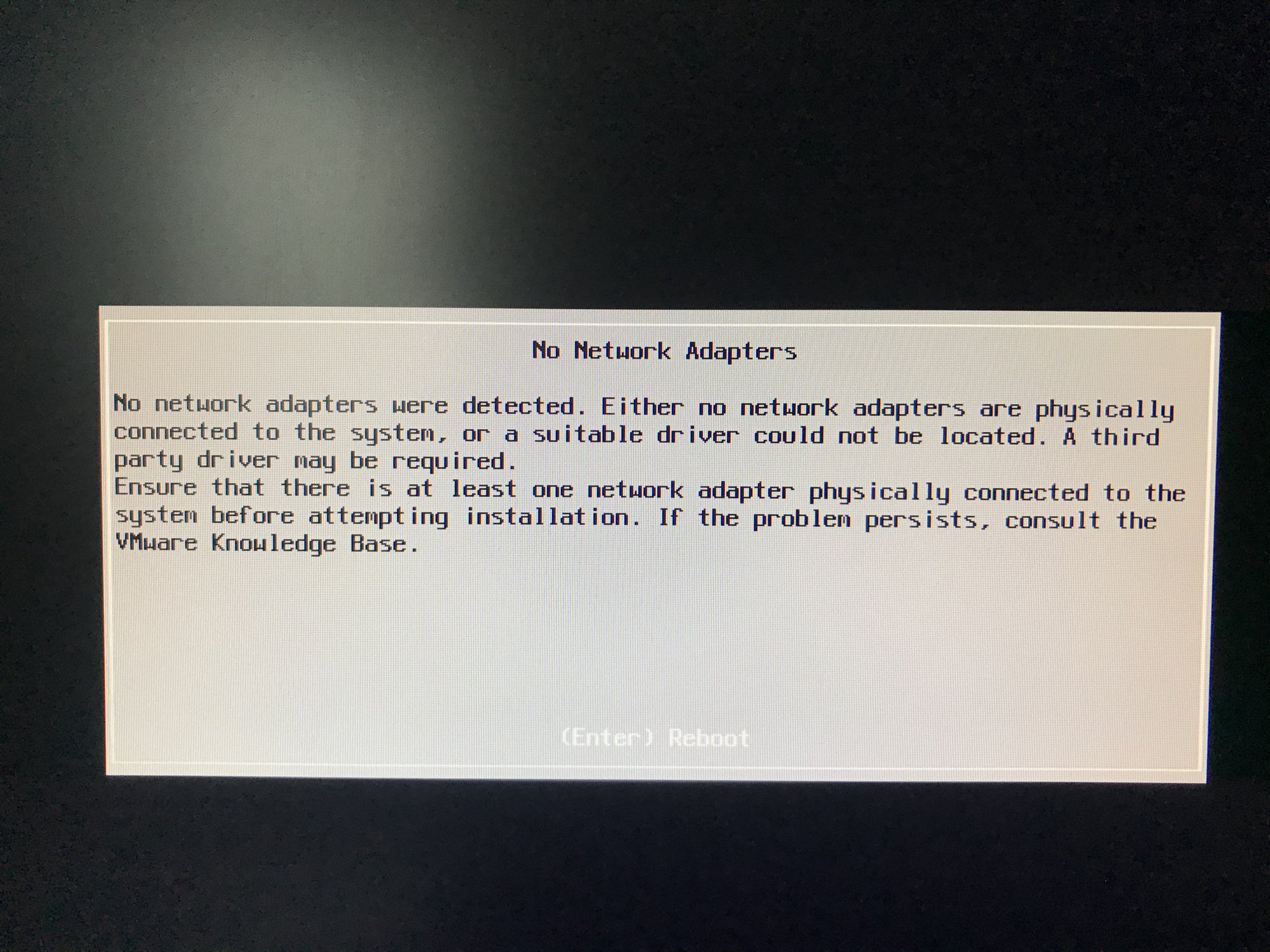

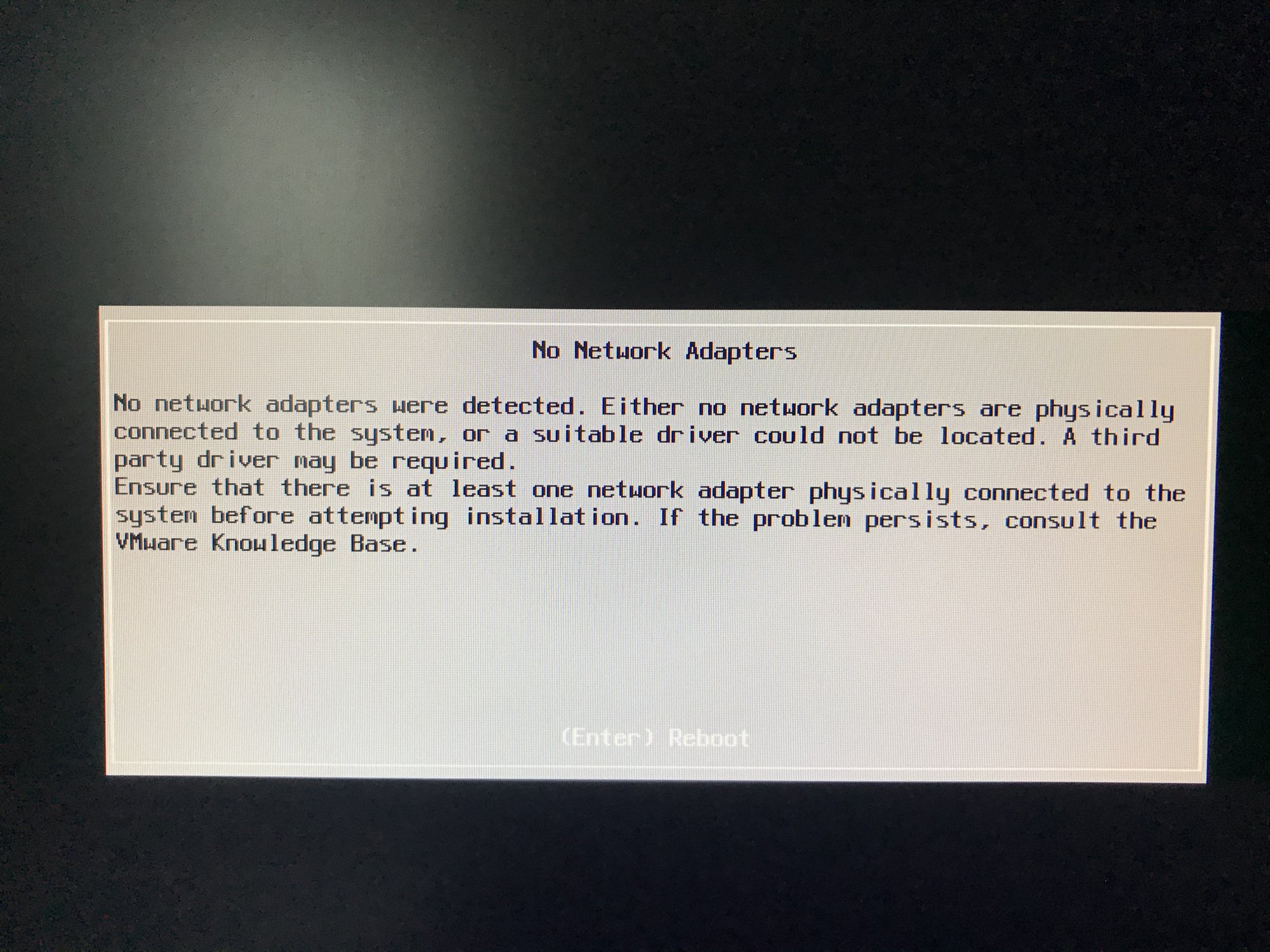

@SecuritySteve Ok so had to use Rufus on a Win10 VM to create the bootable USB stick as the tools on the mac were just not doing it and making it bootable.
Was able to boot ESXi was displaying on my 4k display then would go black. Disconnected it and I could get further in the install process but it is complaining about there not being any NIC Cards attached, So it looks like there are no drivers in the standard ESXi 6.7 update 3 release.
Like I said probably best to wait till its on the HCL with VMware. I might be possible to add in drivers to the installer ISO but I'm not going to go that far today.
Sorry for the bad news.

@CNDCodewarrior Thanks for the additional testing of ESXi on new 2019 Mac Pro. I was really hoping the on-board NICs would be similiar to those of the 2018 Mac Mini and the screenshot that Mike B took on Twitter was mainly due to his monitor. Since we don't have the new system (just yet), would you mind generating a support bundle (switch to console using ALT+FT1) and then login with root (no password) and then run "vm-support"
Once the bundle has completed, what you can do is simply cp the file directly into the USB key (which has the ESXi installer). This is one trick I use to grab support bundle/files. Once you've got it on the USB Key, you can simply copy it off back to your system. Feel free to DM privately
I’ll try to get to that today for you. Glad to be of help.
