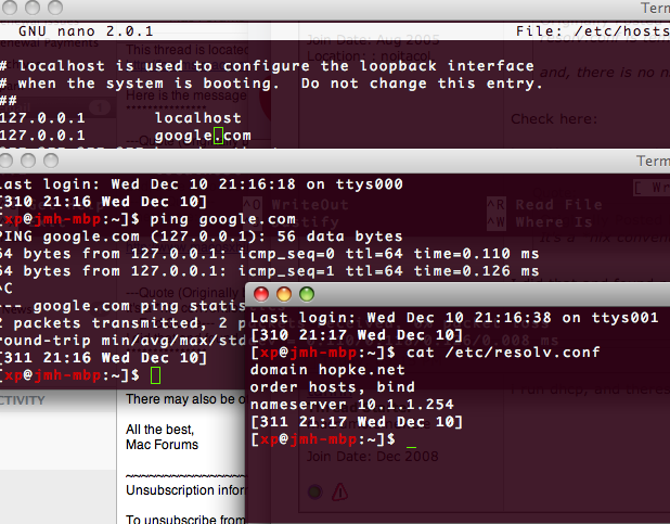

order hosts, bind works
Try it, if it doesn't, delete the line. Regarding reboot, just put a bootup script that copies ~/myresolv.conf to /etc/resolve.conf
simple.

Did you even try the command?
yes i did, look:
marc-anssa-macbook-pro:~ manssa$ lookupd -configuration
-bash: lookupd: command not found
lookupd does not exist in leopard.
