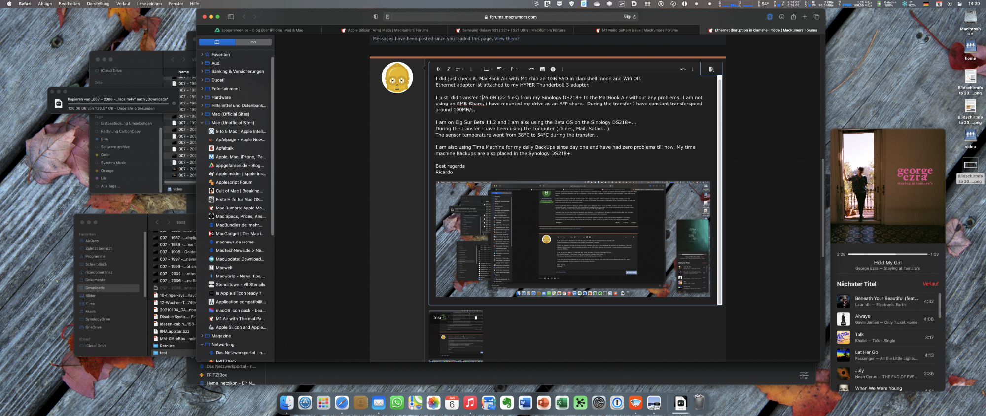

I did just check it. MacBook Air with M1 chip an 1GB SSD in clamshell mode and Wifi Off.
Ethernet adapter ist attached to my HYPER Thunderbolt 3 adapter.
I just did transfer 126 GB (22 files) from my Sinology DS218+ to the MacBook Air without any problems. I am not using an SMB-Share, i have mounted my drive as an AFP share. During the transfer I have constant transferspeed around 100MB/s.
I am on Big Sur Beta 11.2 and I am also using the Beta OS on the Sinology DS218+...
During the transfer i have been using the computer (iTunes, Mail, Safari...).
The sensor temperature went from 38°C to 54°C during the transfer...
I am also using Time Machine for my daily BackUps since day one and have had zero problems till now. My time machine Backups are also placed in the Synology DS218+.
Best regards
Ricardo
