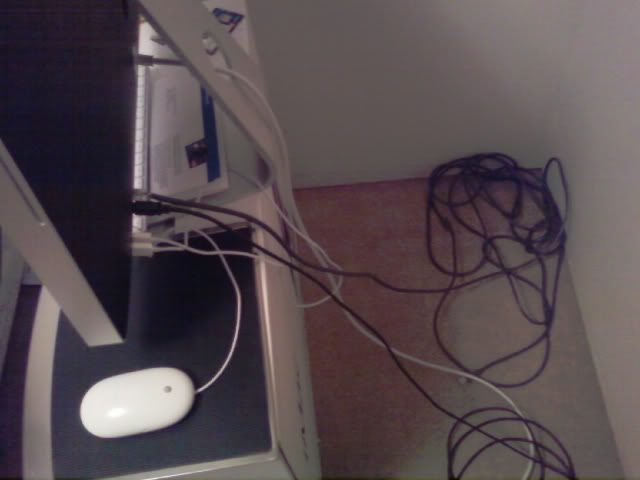

This is a "CAT6" cable and i needed it at one point for wired internet.
I was ASSURED that its basically the same physically, just better bandwidth capabilities. Being as this FutureShop didn't sell anymore CAT5's, i picked it up and sure enough, it fit, and it worked.
When it came time for me to move to my new location, as i was packing my iMac, i noticed i could NOT dislodge the cord from my iMac. I tried, i forced, i wiggled, everything without actually "snapping" or "breaking" anything.
It fit just fine with GREAT internet, no problems, and its fit EVERYWHERE else that needed it (modems and such) with the ability to dislodge, except this.. it feels like its caught on something...
So when the techs at FutureShop tell me its not possible to get it out without breaking the jack, what would YOU do?

Could just be he's pulling on the cable but not realising there's a plastic clip keeping it in place. If you look at the picture above you'll see on top the tiny clip that wedges against the side of the socket. If you can get a fingernail over it, push it towards the cable, ie. away from the socket wall and then pull on the cable.
