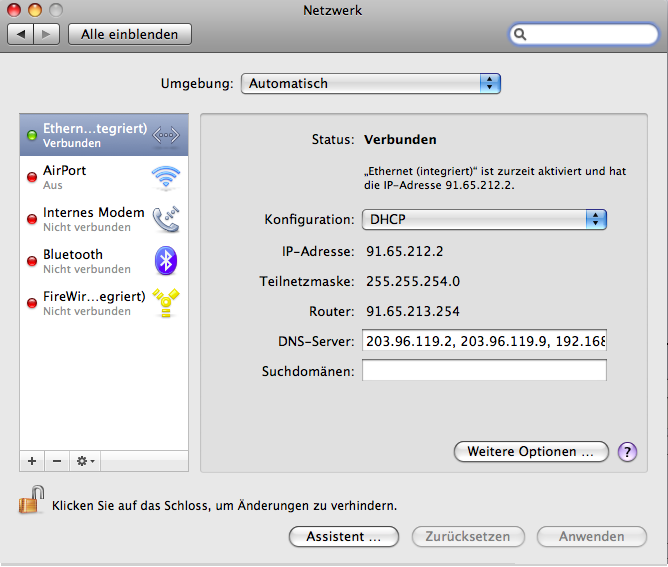

Today I got a new cable modem. Technican came and installed it and DHCP and the Internet worked fine on his PC laptop. I tried it afterwards on my iBook G4 running Mac OS 10.5.2 and as soon as I plug the Ethernet cable in I get over DHCP an IP adress together with subnet mask and everything. Works just fine on my iBook G4.
Now comes the problem. I can't get it working on my Macbook Pro running Mac OS 10.5.2. It just doesn't receive an IP adress over DHCP. I tried EVERYTHING that I could think of and I do know that the its unlikely that you guys would know an answer but I thought I give it a try.
I attached a screenshot of the working iBook network configuration. On the Macbook Pro the IPv4 adress just stays empty.

I don' have a MBP so I'm not sure if it has a link indicator light on its ethernet port. But there should be a green light next to the ethernet plug on your cable modem. Does it light (in the same color) when you plug into either laptop?

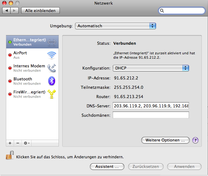

The laptops have no green light indicator but the Ethernet status on both machines show conncted as you can see in the attached screenshot. In other words. The Macbook Pro recognizes that I plug in a Ethernet cable.

Allright!
Next: Can you please switch to english language, and then dump the ethernet tab of the network configuration on both systems? (Or at least verify that they are identically condfigured since you're probably having a hard time getting something out of the MBP)
Also, have you checked if there are differences in the firewall configuration?
The only reason I can think of that your MBP cannot obtain an ip, is that it is either on a different subnet or in the wrong range. DHCP will only go so far, ensure that you have not put any other static settings into your config.

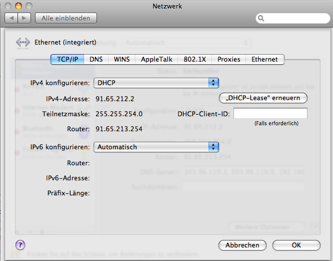

I am not sure how to switch the whole system to english. I did compare the configurations and I even tried to manually enter the IP adress from the iBook (the one it received via DHCP)
I opened up the firewall on the MBP - no change.
The network utility (found under apps/utilitys) clearly shows once I plug the ethernet into the MBP that it is then connected with 100MBit/s
