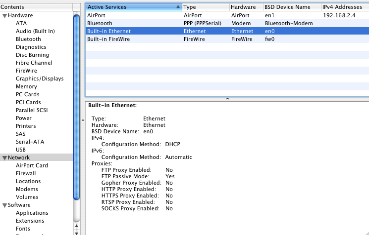

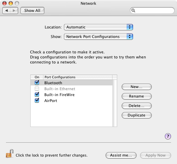

Hey everybody. I don't know how, but ever since I upgraded my Mini's CPU this afternoon, I haven't been able to connect to my network through ethernet. It's plugged in the exact same way as it was before - the Mini to the router, the router to the modem, with the same cables. I can get online with Airport, but not my ethernet. Attached are the Network pane where ethernet is grayed out, and my System Profiler - I don't really know what the stuff under Built-in Ethernet means.
Any ideas?

Try making a new location, and see if Ethernet works from that?
You can also try deleting and then re-adding Ethernet.

If I make a new location, it doesn't see ethernet at all. I deleted it, and when I went to re-add it, these are my options:
(6 to 4) doesn't seem to be anything, as far as I can tell.

Yeah, there's a screenshot of system profiler in the first post. I don't know what all of that means, though, so I can't really tell if it's seeing it or not. I just checked carefully, and there's no physical damage around the ethernet port at all, either.
