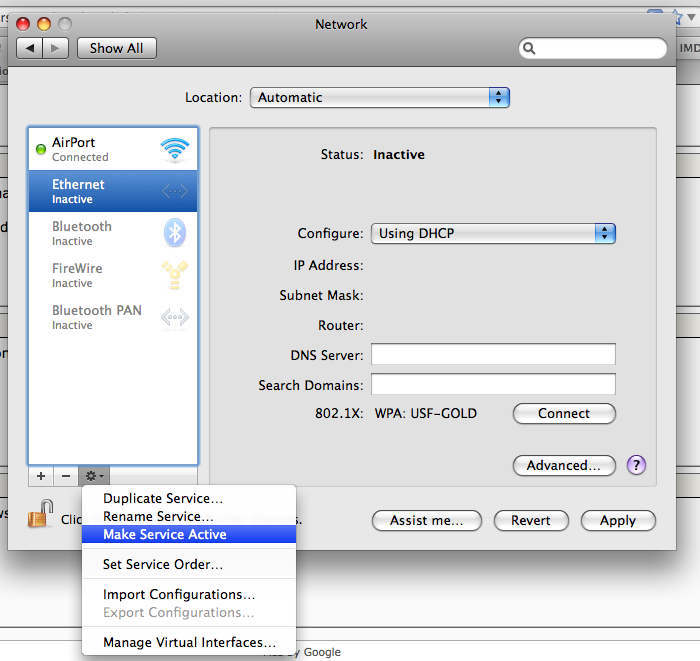

Is you Ethernet port active? :apple: > System Preferences > Network > Select Ethernet > Click Gear symbol > "Make Service Active" > Apply
Picture attached. This is what I had to do. Hope it helps.

Appreciate the help but looks like that is the issue.
