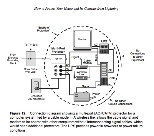

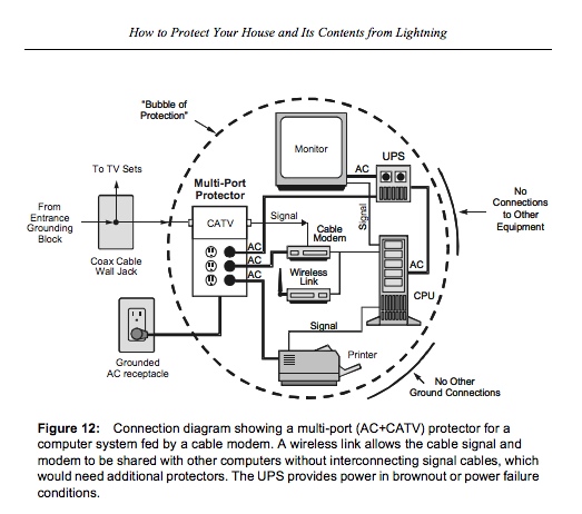

Westom is correct. You are also right about the surge protectors. They are an important part of a surge protection system but as westom said, they can't stop the big stuff. If you do not identify and solve the weaknesses in your power supply, communications, and other residential systems, these problems or worse ones are likely to repeat.
The Institute of Electrical and Electronics Engineers (IEEE) has published a basic guide to surge protection, How To Protect Your House and Its Contents From Lightning. http://www.lightningsafety.com/nlsi_lhm/IEEE_Guide.pdf
Although everyone should pay attention to these essential systems, often the hardware involved goes decades without inspections or maintenance. Last summer my quick check of a (telephone) Network Interface Device (NID) revealed that the ground rod was not connected to the telephone hardware. The telephone technicians fixed the problem after I mentioned it. I do not know if the repairs would have occurred if I had not known what to look for.
Call a contractor if you are not able to complete the required inspections to verify that you have protection beyond simple "point of use" devices such as surge protectors or UPS systems.
Some pioneering work on this subject was performed by Benjamin Franklin. http://www.benjaminfranklinhouse.org/site/sections/about_franklin/physicstodayvol59no1p42_48.pdf
