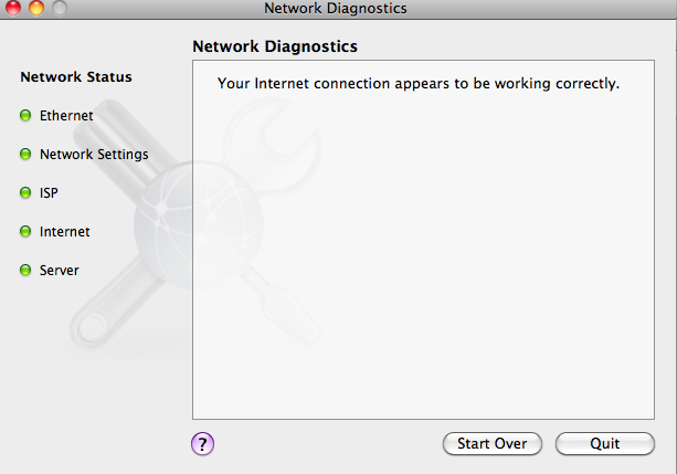

ok, problem definitely seems to be on the Mac side.
Reset my router, and the macbook still couldnt connect to it. Its odd. It seems to resolve domain names, but then just waits....and waits....
Run network diagnostics and then post your picture here.
Network diagnostics will definitley tell you where the problem is.
Don't make a lifetime issue out of something simple to fix.
--Eric
attachment.php
This is the problem. To all intents and purposes, my mac thinks I am connect to the net. I can ping, lookup and stat and traceroute.
It just seems that my mac wants nothing to do with any data that comes from the router.
Admittedly the traceroute seems a bit iffy, but this could from the packages never reaching my computer, and therefore never being Acked.
