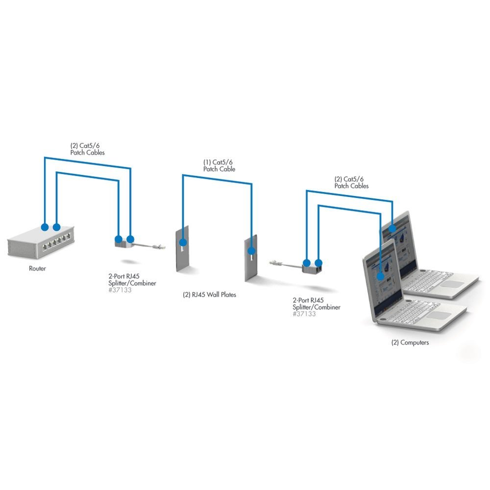

I know this is probably a dumb question, but would it be ok if i use one of these? I know, i'm cheap. 😀
Should work fine. It's basically the same thing that I linked to. But, remember, you won't be able to get gigabit speeds with a splitter. If memory serves me correctly, you will be limited to 10 and 100Base-T speeds with a splitter. Also, remember you're going to need one one each end.

No.. you cannot split an ethernet signal. What you want is a switch. They are cheap.
Read the replies to the product you posted. All of them said it doesn't work.

You must've missed my posts. It is possible to split an ethernet cable to accommodate two devices. The reason this works is because 10/100Base-T only uses half of the eight leads of the ethernet port/cable.
If the ethernet is in-wall, it may be more aesthetically pleasing to split a cable at the ends than to run another cable that won't be in-wall. There are no disadvantages if your equipment only have 10/100Base-T ports. While you can add a switch or hub at the end, that adds another piece of hardware and, along with it, the need for another outlet (and, very possibly, a wall wart power adaptor) and use of electricity.
