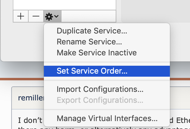

Wired ethernet will almost always be faster and more reliable than wifi. I run my MacBook docked and over ethernet with the wifi also on.

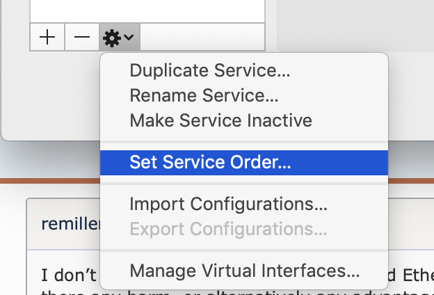

Set service order like @dazlicous mentioned with wired on top so when wired is available it will run off that.
Even when on ethernet, you want to have the wifi on and connected so things like location services and handoff/continuity will work.

Great tips everyone! I didn't know I could set the Service Order. I had the wifi turned off and was only using ethernet. I can once again unlock my iMac with my Apple Watch. Thanks

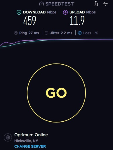

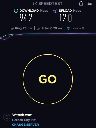

OK, just ran two tests a couple of minutes ago. My provider is Comcast cable.
First, via ethernet (my Mini is connected to the Comcast gateway downstairs via a LONG 75' ethernet cable, which may only be cat5):
Next, wifi (using a 2-node Linksys Velop system):
(You'll note that the source is two different servers. When I tried connecting via ethernet to Optimum Online, I got a slower result)

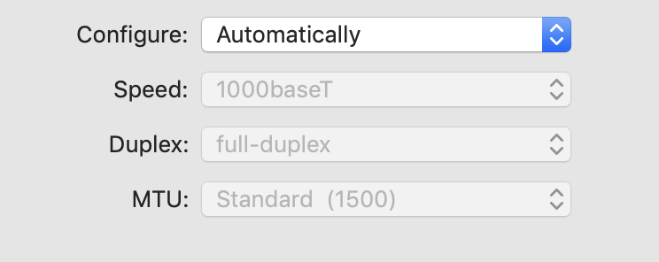

Here is mine with a 1000Mbps connection.
Unless OP's AE is very old, it would be a 1000Mbps connection over ethernet.

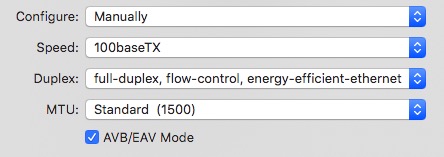

OK, I looked, here's a screenshot:
2018 Mac Mini, OS 10.14.4.

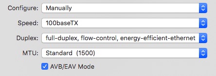

Fishrrman, I notice that your Ethernet interface’s hardware appears to be configured manually to 100baseTX. What happens if you set it to configure automatically?
Colonel wrote:
"I notice that your Ethernet interface’s hardware appears to be configured manually to 100baseTX. What happens if you set it to configure automatically?"
Heh.
I didn't think that would make a difference.
So... tried this:
- changed from "configure manually" to automatic
- disabled wifi (so only ethernet is active)
- ran SpeedTest again
- got 478mbps download and 12mbps upload.
Amazin' !
I'll have to check that long ethernet cable again. It just might be cat5e after all.
