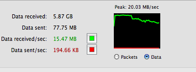

Actually, I think you're both right - and wrong. According to this review at Ars Technica, actual throughput is on the order of 40mbps, far shy of the 100mbps (or more likely 80 or so) you get from wired.
I can easily maintain 15 MB/sec (126 mbps) with my Macbook and Airport Extreme Base Station, with peaks to 20 MB/sec (168 mbps). Your mileage may vary.
A.
