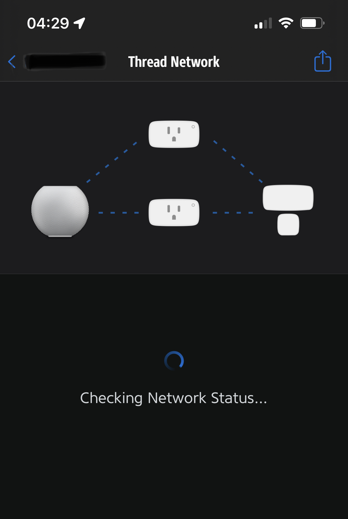

I have seven HomePod Minis, an ATV 4K (2021), and a Wemo Stage Scene Controller with the Thread firmware update. That’s about the extent of my Thread devices for now. When I open the Thread Network setting in the Eve app, it just stays stuck on “Checking Network Status”. It’s been like that for a long time. Anyone know if Eve requires you to have at least one Eve device to take advantage of this feature in their app? I already tried uninstalling and reinstalling the Eve app but still the same.
I think you are right, you would need a thread device on the thread network in order to get any status stats. That is interesting any chance you can score a thread device to use?
I have the Wemo Stage Scene Controller with the Thread firmware update. The HomePod Mini and ATV 4K 2021 are supposed to be Thread border routers and should show up in the network as I’ve seen in videos. I planned on getting an Eve weather and a few of the Aquas anyway but curious if there has to be an Eve branded device on the network for this app feature to work. Maybe a way to get you to buy their products, which I have no issue with.
I can't imagine that? I bet the firmware update to enable Thread somehow didn't install correctly. Can you reset the Wemo Controller? (Auto correct sure doesn't like the word Wemo) 😡
Reactions: Itinj24
This is what the Eve app did for me before I got the Eve Energy smart plug with thread. Once I got that, thread network information such as function, links and signal levels became available.
Reactions: Itinj24 and srl7741
Ok so that pretty much confirms my suspicion. Thanks for that 👍

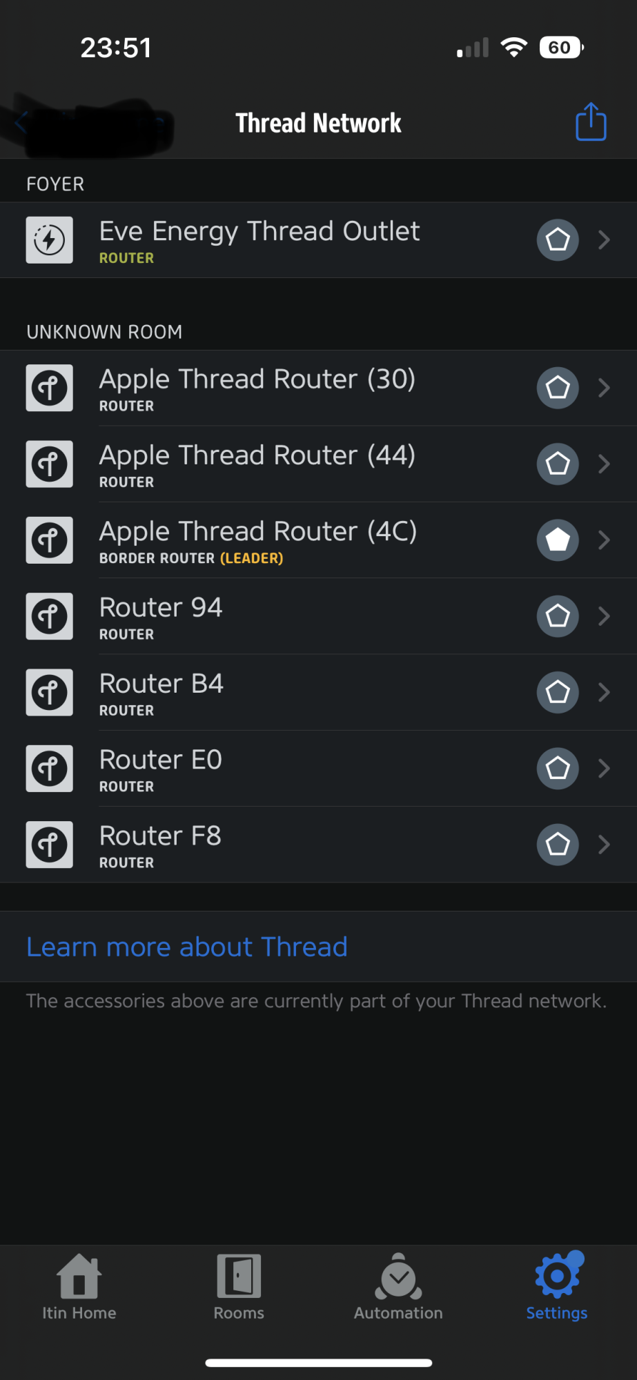

So I went ahead and purchased an Eve Energy just to see my Thread device map. Below is a screen shot. Is this what everyone else is seeing? All the other devices that are in an unknown room are a mix of HomePod Minis and a Thread enabled AppleTV 4K. I assume the room is unknown since the Eve app doesn’t support AirPlay2 devices as controllable like the Home app.
Can anyone decipher what those two digit numbers/letters are in the parentheses and the other ones too? They don’t appear to correspond to serial numbers. And why do some of the devices say “Apple Thread Router” and some say “Router.” Other than the Eve Energy, all others are definitely Apple devices. Appreciate any insight.
Let me see if I can get most of these points, in no particular order:
The 2-digit codes are likely the last 2 hex digits of the device's Thread MAC address, and of little use if they don't match the known MAC addresses of devices you have. A device's WiFi, BT, and Thread radios each have different MAC addresses. You can try to track them down by unplugging a device and seeing which one vanishes.
Thread Network/Router Identification:
- Apple Thread Router = Currently either an Apple TV 4K or HomePod mini.
- Thread Router = a non-Apple device that has the role of Thread Router.
- Do you have 7 HomePod Minis or mini+ATV4k? Then I can't explain why they don't all say "Apple".
- If you tap each a device in the list, you'll get more info about it, but it probably won't help you figure out much.
- Also, your Eve Weather is missing. It's not currently in the Thread network; i would reset it and re-add close to one of the Apple devices.
Unknown Room:

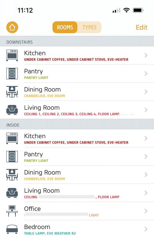

This does not look correct. All my Home configuration automatically populated into the Eve app. This probably means a disconnect between your Home.app setup and the Thread network, or other configuration problem. What do you see in the Eve app Rooms tab (see attached)? In the Home app, do you have rooms set up? (when you tap the 3-dots at top right do you see the list of Rooms?) Do all your HomePod minis and ATVs appear in the correct rooms? Check all the Apple devices are up-to-date? I just remembered, long ago I added some speakers (non-HomePod) that ended up in "Default Room" in the Home app. So start by making sure devices are assigned to the correct rooms in Home.
Thread, in General:
Thread is surprisingly long range considering the low power of endpoints like battery operated Eve Weather. You shouldn't have to spend time managing it; the Eve Thread Network Maps is useful as curiosity. Thread is self-structuring and self-healing. I find it very reliable and refuse to use any BT devices in my Home-setup. This is a great primer on Thread: https://openthread.io/guides/thread-primer
Let me know if that helps.

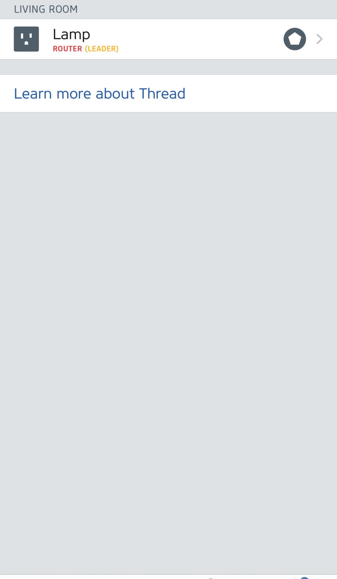

My Apple stuff doesn’t show up at all. Am I doing something wrong or do they show up as you get more thread devices?
I didn’t do anything special. All I did was buy an Eve Energy for the thread map to show up and it did.
I thought my Apple TV 4K and HomePod Minis.
Yeah, they should appear there since you have a Thread device they can talk to. Does your lamp appear in the Home app on iPhone? Can you control it via HomePod mini?
That’s about all I can think of. You might want to look at this site for more info about Thread and HomeKit.
BTW @Itinj24, on the Eve Thread Network page, my ATV and HPm both show as “Apple Thread Router” under Unknown Room. I was My guess is that since the “Thread Router” part of Apple devices isn’t accessible through Home.app, they aren’t assigned to a Room, therefore Unknown Room.
Unknown Room:
Thread, in General:
Very much appreciate your time for this reply…
I was just hoping to be able to identify which device is which with that two digit code but I can’t tie it to anything. Eh, pretty sure it’s useless anyway, like you say. Just curious what they were.
All those devices, aside from the Eve Energy at the very top are Apple devices. One ATV 4K and the rest are HomePod Minis. They should all say Apple Thread Router but they don’t so no clue what’s going on there. Yeah, tapping on the device doesn’t show much more info either.

Yes, I absolutely created rooms in the Home app which populated in the Eve app. As you can see in my screenshot, the Eve Energy is correctly placed in the “Foyer” but all those other (Apple) devices are not assigned to any rooms. Do you have Apple devices assigned to rooms in your Thread device list? I figured they wouldn’t since the HomePods and AppleTV’s to show up in the Eve app so they aren’t speaking to the Eve app as devices in a room. Yes, all the HomePods and such are assigned to the correct rooms in the Home app and they’re all on the latest OS (16.0).
Thanks again for your insight. It’s not the end of the world. Just curious how my Thread map looked. I was actually expecting it to look like diagram map, not a list of devices.
Ok Gotchya. Thanks. I just replied to your previous post. Was busy all day and just got around to it so disregard the part where I mention this lol. I’m thinking it’s because the HomePods and ATVs don’t show up in Eve as devices but who knows for sure.
The lamp is actually a Wemo Mini smart plug controlling a lamp. It appears in HomeKit and works fine, although I have had issues before but it’s been good since.

Haha. We were typing at the same time! At this point I really don't know enough about how HomeKit+Thread is implemented, but you know, I don't think Apple intends us to muck about under the hood. I could conjecture up some thoughts on why you're other HPM show up as just "Thread Router" but it would be just educated guesses -- namely you don't have any need to connect to other devices using Thread, e.g. more Eve devices. You might try moving the Eve Energy plug around and see if that changes the "Apple Thread Routers."
Two final thoughts:
- If you want to match up the letter codes to HPM's you could unplug them one at a time and see what disappears.
- Look in your Home app > ... > Home Settings > Home Hubs & Bridges. Do ALL your HPM's show up here? My guess is, no.
Best of luck!
Reactions: Itinj24
Maybe my problem is I don’t have any Eve devices and I’m using their app to view my thread network.
That's a good thought, but the Wemo still shows up as a device. Don't know enough about Wemo on boarding, but the display implies that Homekit isn't using Thread to contact the Wemo. Not sure.
