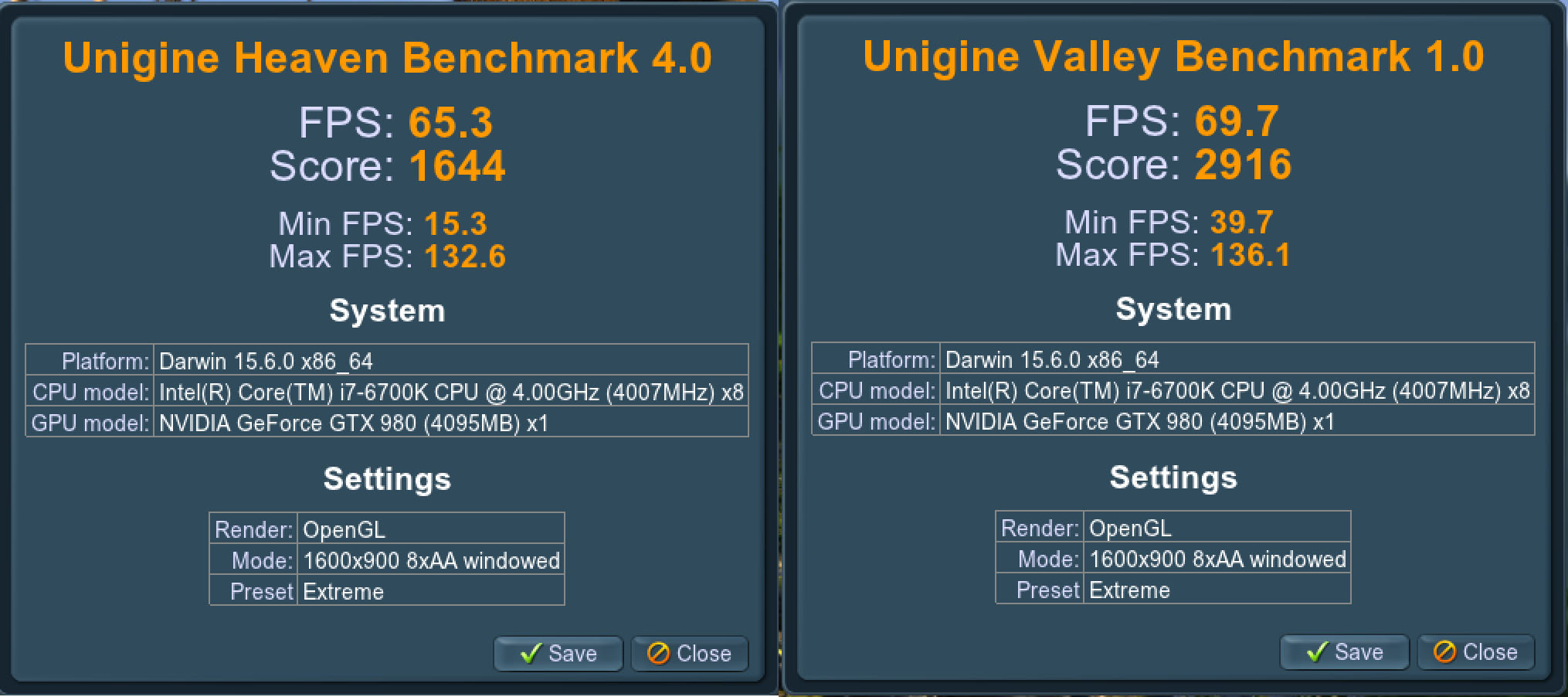

As long as you know you will be stuck with slowish OpenGL performance (equal to a 680),
GTX 680 OpenGL:
GTX 980 OpenGL:

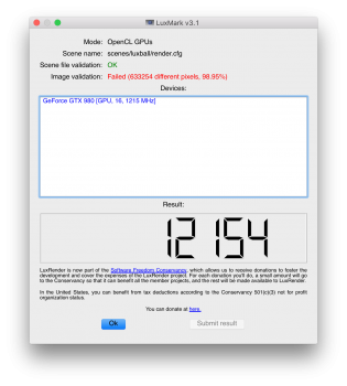

CUDA/OpenCL around 20% slower than Windows,
Mac Cuda/OpenCL:

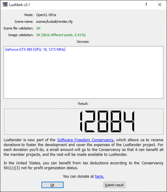

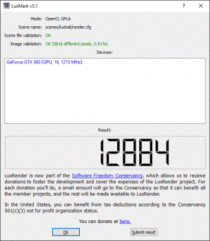

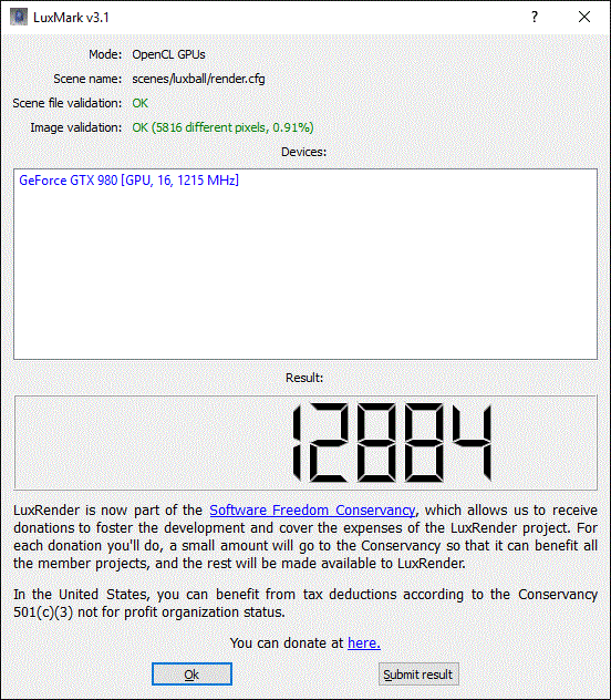

Windows Cuda/OpenCL:
The Windows result is from a test I ran in the past. I don't have time to run Lexmark in Windows at the moment... Will follow up at a later date.
