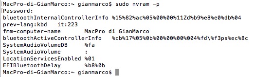

Hi, i guess it didn't work. Everytime i reboot osx driver is selected on nvidia driver manager and from terminal no sign of nvidia driver.
Try wiping the NVRAM at boot, that might help. Does it remember other settings (e.g. boot volume or audio volume)?

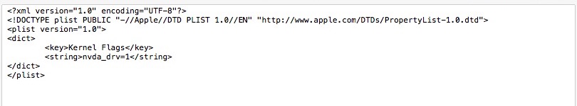

In case you can't write the NVRAM, you could still add the boot flag to your boot.plist.

this is my boot.plist
