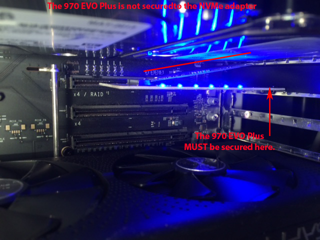

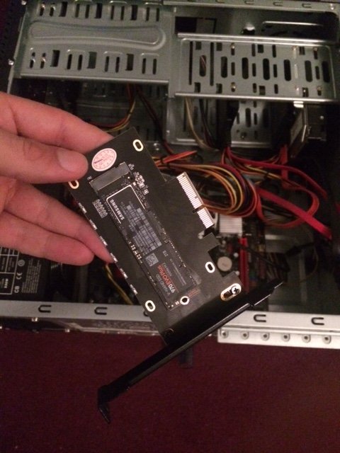

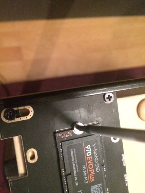

In post #13. your 970 EVO Plus is NOT secured to te NVMe adapter ! It is at a 40° angle
This is 100% WRONG.
it MUST b LOCKED DOWN o the adapter

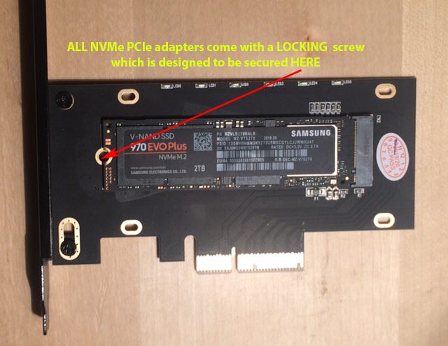

In the box that your M.2 NVMe PCIe adapter came in. . there should be a TWO PART locking insert and a screw.
Shut down your Mac Pro
Remove the Mac pro's power cord.
Wait 5 mins
Secure the 970 EVO Plus to the adapter
Now . ..
start up your Mac Pro using the "Three Consecutive HAPPY MAC Chimes" = hold down these keys P + R + Option + Apple keys until you hear the "Happy Mac Chime" THREE times.
Now. . check "About This Mac / HArdware/NVMexpress to see if the FIRMWARE Version is shown.

Thanks for the detailed review and effort you did here. I just deleted the missleading picture on post 13 in hope to not get more comments on this very exceptional "variation" I tired after not having any success with "normal" methods.
Regarding the screw drivers. They weren't attachable in a stable way, i tried many times. After it didn't work as expected, I just relied on the conductive paste where the blade (as shown on the photo) is attached as it should or at least as aproximateley as it should for testing purposes, because I ordered it via ebay and the seller is waiting for me to aprove it's working, while I have no life sign of the blade so far. It is just a single life sign I am craving for by now (after that I'd have my head free to thing about buying another adapter card anyway)
The P-R Reset I did yesterday as suggested by @ Macschrauber with 5 chimes even, I'll try it with three chimes this time to leave nothing untested.

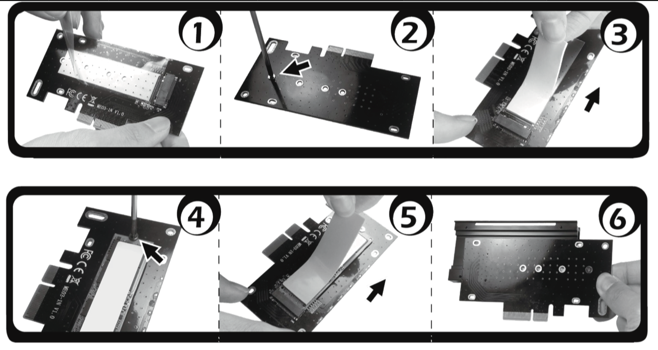

This is from the instruction manual. I'll try out the most THIN of the 3 Pads (for the screw to work)

You seem to have done everything the wrong way.
I found this by Googling in about 10 seconds. Your should have Googled too.
Start watching from 7:58
1. Shut down, remove the Mac Pro's power cord.
2. Remove the HEAT PAD completely from the adapter - you can put it back later.
It is not required at this stage.
3. Now attach the two-part adapter security screw along with it's bottom half as indicated in the 2nd. photo
in Post #26. One part is installed from the BOTTOM of the adapter. The screw in inserted from the top of
the adapter to lock down the 970 EVO Plus to the adapter.
4. Restart doing the THREE consecutive CHIMES NVRAM "re-set" (Not 5 chimes ! ) ( who said five chimes ? )
5. Now re-boot the " Unetbootin " USB stick.
Y
our 970 EVO Plus should now be seen and be able to be flashed to the current 2B2QEXE7 970 EVO Plus firmware.
I assume that you HAVE NOT already formatted your 970 EVO Plus in Mac OS because if you have .. . then you will have to use Samsung Magician in Win7 or Win 10. but before you can do that you will have to format the blade to WIn standard format specs.

I would never depend on ANY heatpad securely holding down ANY M.2 blade to an adapter.
Asking for trouble.
M.2 blades can get quite hot.
The two-part secure retainer is included with all M.2 PCIe adapters for a good reason.

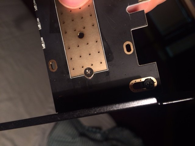

SO just to keep on reporting you guys how i proceed:
[automerge]1594638473[/automerge]

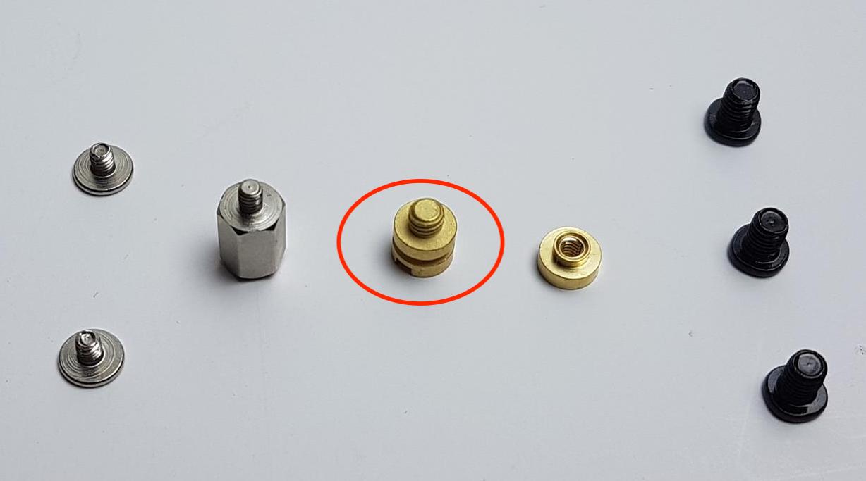

(the one part for the back)
and although it might look as if it could work:
there is really NO WAY to get this screw in there WITH the Heat Pad (and even the most thin of the pads) mounted.
SO to exclude every single possible error, I'll no go on and test it without the Pad though i remember heaving hat difficulties with using the srew even without the Pad. But I'll keep on trying my very best... (again with all the P-R-RAM Reset procedure of course)

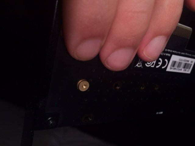

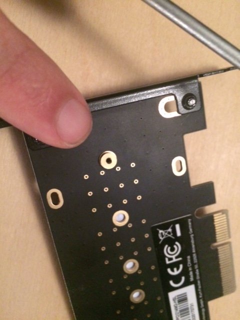

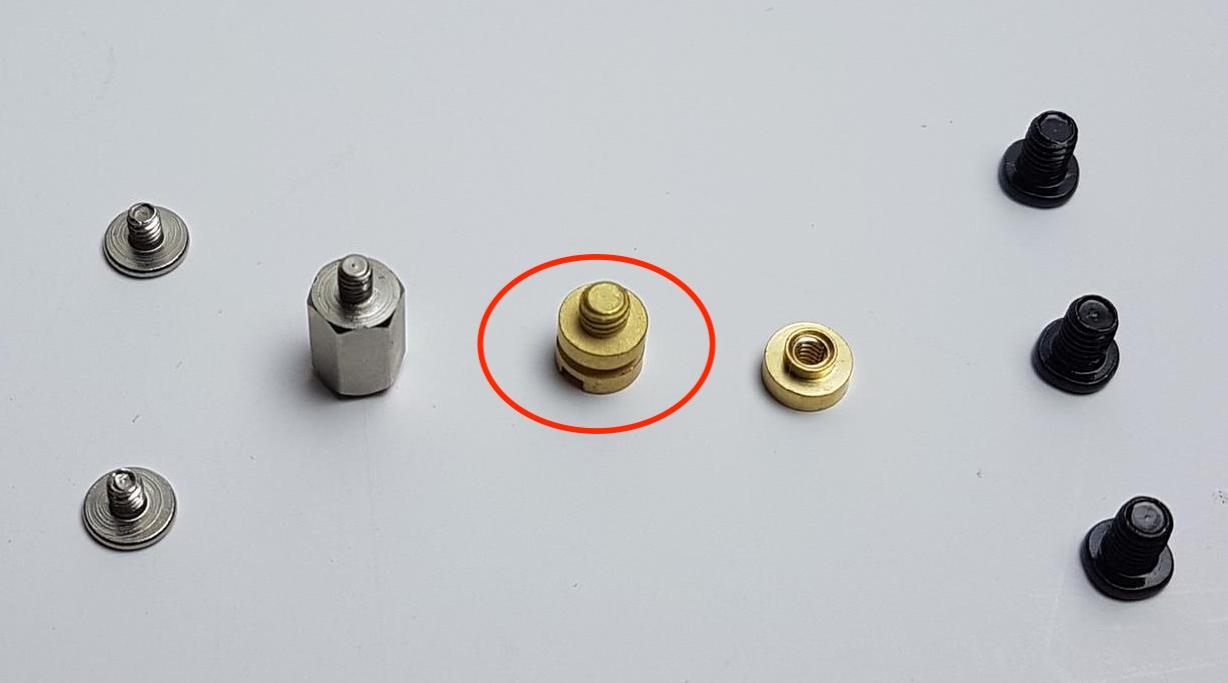

ONE part of the TWO PART locking items = the receptor for the ( top ) screw is mounted from UNDER the blade adapter PCB.
( Google for videos . . it's dead simple ! )
Example : Google for " How to attach a M.2 NVME SSD to PCIe adapter? "
The LOCKING SCREW goes into the "screw receptor" = mounted UNDER the adapter PCB board.
NOTE : You DEFINITELY DO NOT NEED to attach HEATPADS to test your 970 EVO Plus connection.
The heatpads can be added LATER ~!

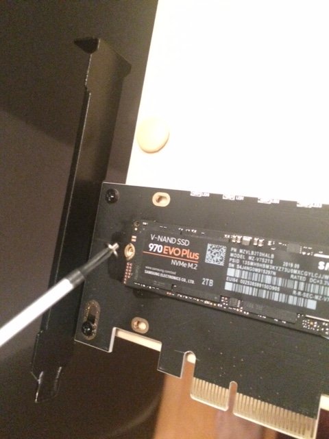

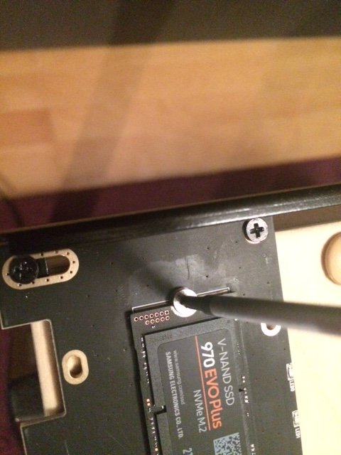

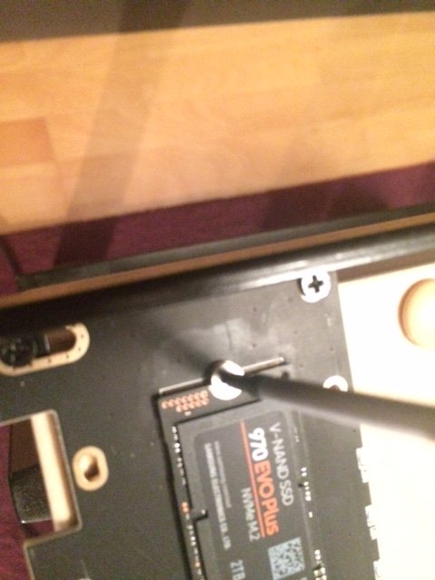

It's nothing really new but this time I went with most precision in documenting how I am approaching it:
WITHOUT the blade i CAN attach the screw without much problem:
-> as can be seen from both sides. The Screw sits perfectly attached.
WITH the blade mounted though i can't get the screw fixed anymore as one would expect:
Although it looks like it should be possible, its not and i tried very hard:
Propably becausee its sitting crooked, see? So the screw is to short to even reach the "screw receptor"
Therfore I just used the most thin of the Heat Pads as WORKAROUND as described by
@KeesMacPro
-> Thank you again for the great hint.

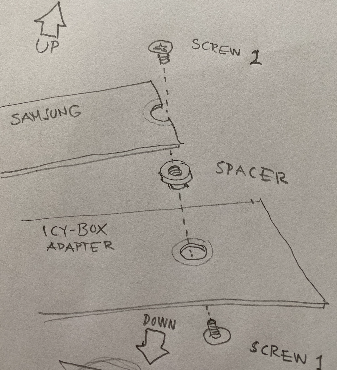

no, thats too tight
red thing needs to be mounted between pcb and blade. As likely, its a spacer.
Well this Spacer kind of piece was not part of the Set (also the piece to the left wasn't part of the set i recieved) I only had the golden one and the flat screws to the left. They work without the ssd but not with it. I would guess that the propability of the problem occuring because not having used srews in my attempts can be almost neglected no?! Of course it's a little weired that seemingly one piece is missing, but the blade really seems prety tight and well placed while the Card is being recognized without any Problems.
I just phoned with the very FREINDLY(!) RaidSonic support though about having ordered a card which is explicetely Mac compatible (and older!) while getting this newer model after having chosen the option "with cooling piece" in Amazon. He wants to look into that. At 1st he was sceptical about that being a problem because, as YOU mentioned it should just connect the SSD to any Hardware with the right Bios (supporting NVME) but he after mentioning PCIe 4.0 I got him to think. He guesses this is not compatible with older mainboards, only with very new ones and asked me to tell him what the information is shown on my Mac. As I tolled him, that it is recognized as AUDIO Device he said that this SHOULDN'T be the case and advised me to exchange this for the modell of the Icy Box which is known to work properly on my Mac.
My concrete Question is if especially you or anybody else here is able to reconstruct what can be seen on "about my mac" if no blade is being attached to the Icy Box? Isn't it weired still after all, that it thinks it is an Audio Device?

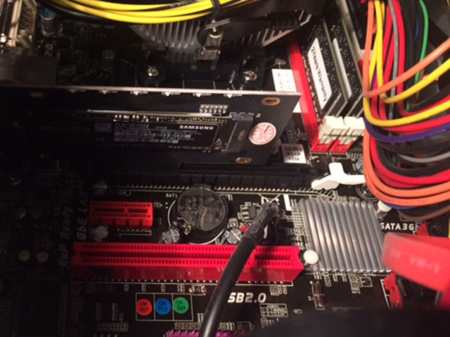

ok guys Thx so much for your patience!
After quickly having installed it in a windows 7 PC:
I still couldn't get any life sign of the blade. Unfortunateley it's Windows 7 (I have a Windows 10 PC were i could test it as well). In any case, as I wanted to install the Samsung NVME Driver, it tolled me "there is no NVME Drive"
Therefore I start to think that we have a real basic installation problem as anticipated buy you guys. Maybe its because of the wrong screw set @ MIKX!

I remember scratching my head with some of those cheaper adapters sometime. If you want to give it that one last try, I'll post a picture how you might try this. I am not sure if you already did this, but it doesn't hurt to post this anyway.
I believe tha spacer has been on the wrong side. You've got two screws, right, and one spacer. So maybe try like in my picture. If it does not help, you need better/correct screw set and spacers, or a working adapter card, because that one might just be DOA.

So the original result: I went to a special PC Store to really just test the Evo Plus and ... it has been identified as totally CORRUPTED!
No wonder therfore that we all kinda "scratched our heads" in a different way from different perspectives, @ Macschrauber having been the closest to the truth with his evaluations.
But I wouldn't think of all this effort we made together as just wasted time becuase we get a quiet precius Conclusion, at least in my eyes, which can serve future people wanting to install a NVMe in their machines:
IF the blade isn't even recognized by the Mac (not offering to earase disk) one can assume with a pretty high probability, that it's broken! No need 🙅🏻‍♂️ for fiddling arround for two days like I (we) did 😂
