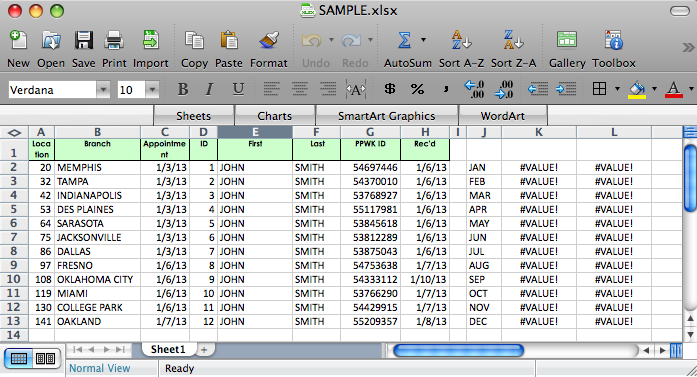

I have attached and example of what I am working on. As a point of reference , just in case, I also attached a print screen of what I see, in case you open it and there are no problems with it.
Ok - got the file. Can you tell me the exact formula you want in K1-13 and L1-13? I didn't fully understand your description above of what you are trying to count. We should be able to get this to work today.
