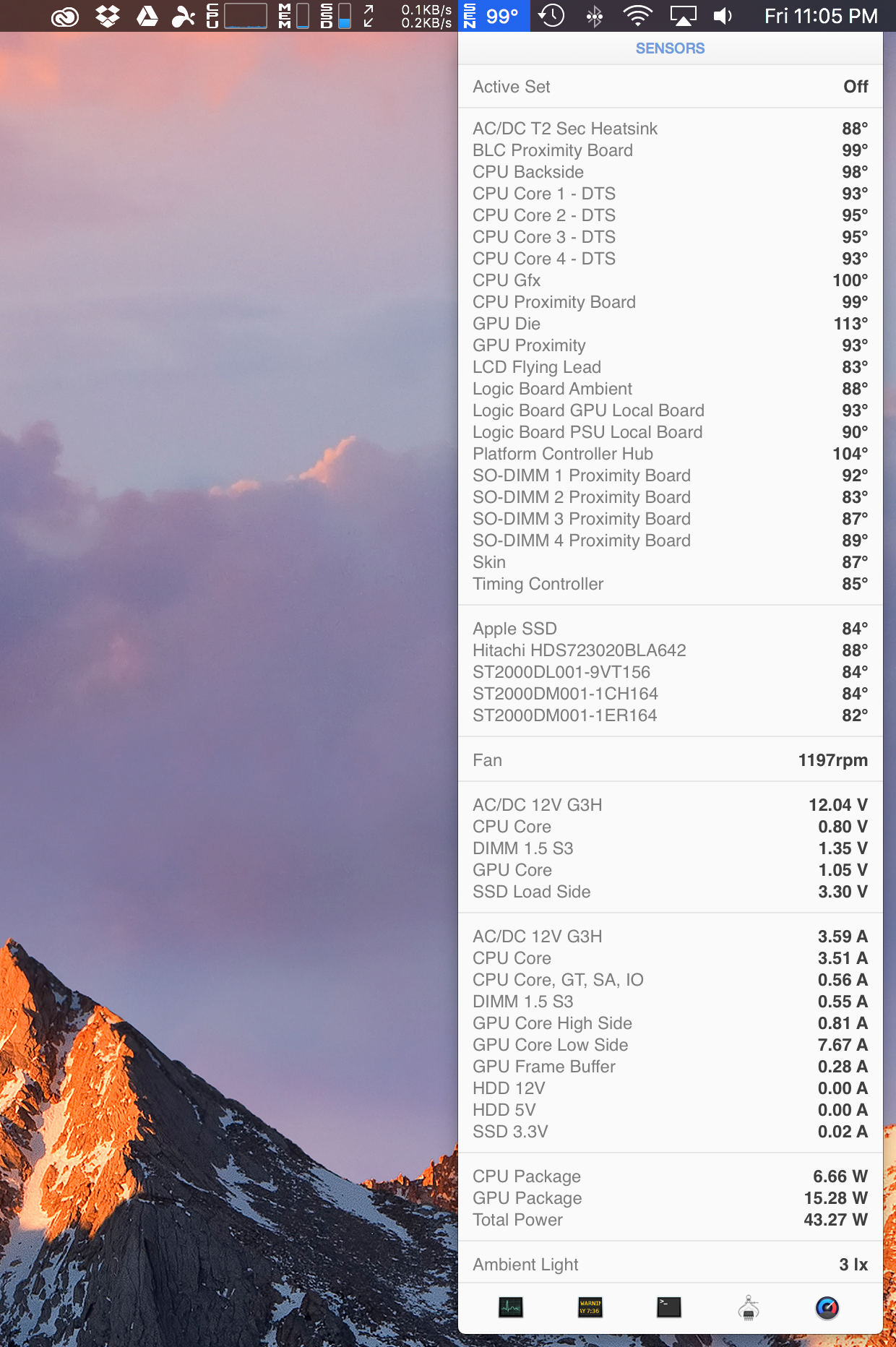

I've got lots of ideas for you, but let's try some basic things first. Disconnect everything but essential components only (keyboard, mouse) and download istat: https://bjango.com/mac/istatmenus/. This will help you monitor CPU temps, memory temps, fans etc. Get a reading of your computer hanging out doing nothing important.
My Late 2015 iMac likes to idle (light web work like typing this) around 98F. Fan at about 1200 RPM. Get a reading of what is going on.
I suppose it's possible your computer was trying to back up to TM or was indexing itself. Also, what version of OS are you running? Don't run the VM for the first temp reading, it's possible something with that was causing the computer to overdrive. What model computer is it? 27" 5k?
