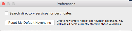

I went through all the steps of removing all the devices and resetting networks. The iCloud Keychain, when 2-factor authentication is enabled, contains a lot more than just data like logins and passwords and Apple doesn’t document what that is nor do they provide a way to remove it all. On my Macs, the iCloud Keychain database, which would normally be about 10 MB or less grows to nearly 500 MB.
How are seeing storage space used by iCloud keychain? Keychain Access will show you everything in the database you can also use a security dump in terminal to see the contents of the login keychain (not iCloud unfortunately though).
Turning keychain off on all your devices should remove keychain. However you can also goto Keychain Access > Preferences > Reset My Default Keychains. This will create new default keychains (Login and iCloud) wiping out the old stuff.
It's in /Username/Library/Keychains. It's a SQLite database and my iCloud Keychain database has over 30,000 lines of data being written to it and whatever this data is remains invisible to Keychain Access. This data is related to something called "Manatee" which must be an internal name for something that syncs between macOS 10.13.x computers and iOS 11.x devices.
The security binary doesn't work on iCloud Keychains so it's irrelevant to this.
Resetting the keychains does not solve this problem, nor does logging all computers out.
