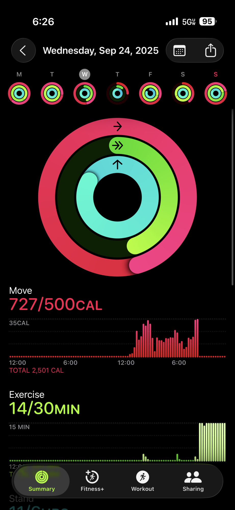

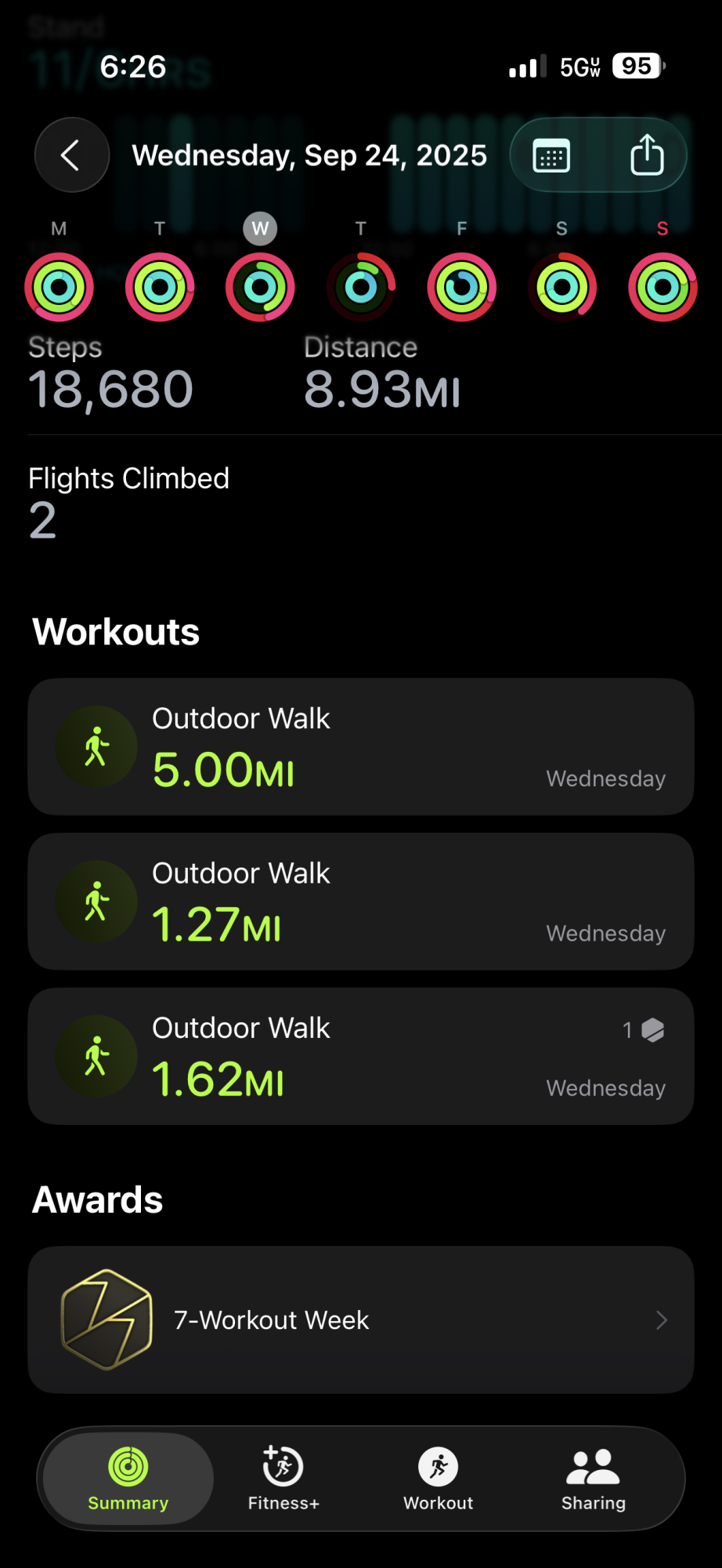

So my excersize ring isn’t closing on my ultra 3 doing walking workouts. That’s Wednesday and I clearly did enough to close it but it didn’t anyone know how to fix?

yr two screen shots, taken together, are interesting.
the only thing i can think of, is if those walking workouts were done at an extremely slow pace. or, were chosen by you as walking workouts, but the actual activity pattern you did was not recognizable by the watch as a typical walking pattern.
in this case, then no matter that you have started to record your walking as a walking workout, it will really only record exercise minutes if your pace of walking is at least a minimum pace. i have only encountered this when i first got my watch and i would set a shopping mall normal shopping activity as a walking workout. the workout was recorded much like your data. it couldn't figure out that a stop and go kind of walking pace was a workout.
however, the total number of bars on the exercise graph (1 bar representing 15 minutes) seems to indicate that your walking pace was not too slow to have triggered that minimum pace.
i do not remember that i ever was able to actually read what the minimum pace was. i think rather than a minimum pace, its the start and stop kind of walking pattern that might result in this kind of anomaly.
